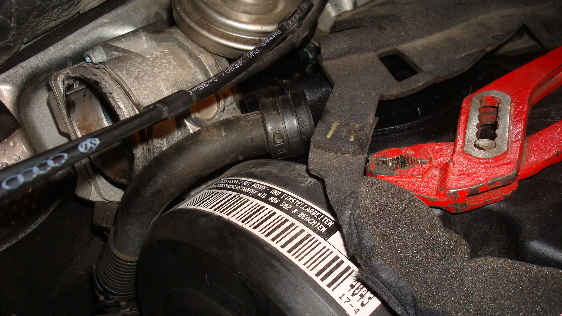

Post05-01-2010, 9:59    Subject: 1.4 TDI Turbocharger Problem: Boost Control Error 17964 Quote
Current status:
The vehicle is working better now, but it still occasionally malfunctions. The error seems to have resolved itself (instrument cluster, EDC).
It mainly occurs in damp conditions.
In the attached image, you can see the throttle valve and the EGR valve.
Below the pressure chamber of the AGR, there is oil.
The AGR pipe and cooler were recently replaced (due to a crack in the metal pipe).
The throttle valve (or swirl valve) is quite dirty, but I can't reach it to clean it. I probably need to remove the EGR cooler and the entire piping system in the back to get to it.
Unfortunately, due to time constraints, it was no longer possible to do any of those things.
