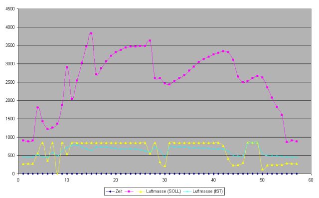

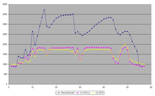

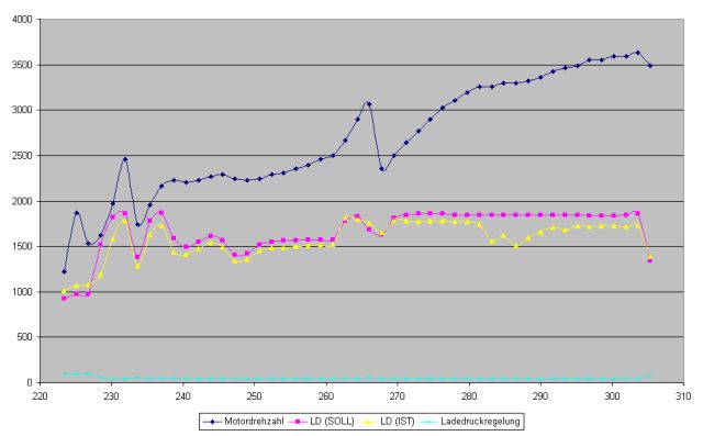

Unfortunately, the boost pressure is good, but the air mass is limited because there's no EGR (Exhaust Gas Recirculation) system. I couldn't get any more performance out of it.
edit: first diagram - another new log
 Ladedruck bricht ein ... hinterer Bereich
