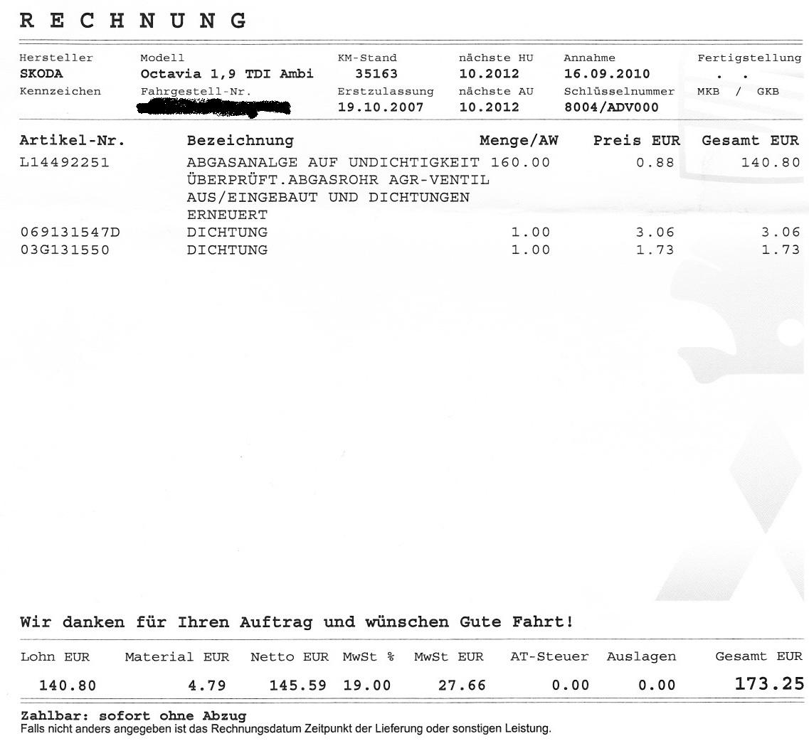

If you know the price down to the exact cent, could you please let us know the part number?
Sure, I would also appreciate a scan of the anonymized invoice.
Then you can infer the installation location and look more closely at yourself.

Post20-09-2010, 19:22    Subject: Quote
Here is the invoice. I was mistaken about the amount, but it's approximately correct icon_biggrin.gif.

Post20-09-2010, 19:37    Subject: Quote
Martin,
The two seals are the following seals:
Exhaust manifold -> Connecting pipe
Exhaust gas recirculation (EGR) cooler connection pipe.
(not the EGR valve!)
Let me see if I can get a picture of her...
EDIT:
Wow, this is really crowded.
BUT:
When looking for a leak, you can also inspect the seals from above. Our seals and their surroundings still look immaculate after 128,000 km. When there's a leak in a diesel engine, it's always accompanied by black soot.
And you definitely had that issue with the seals!
