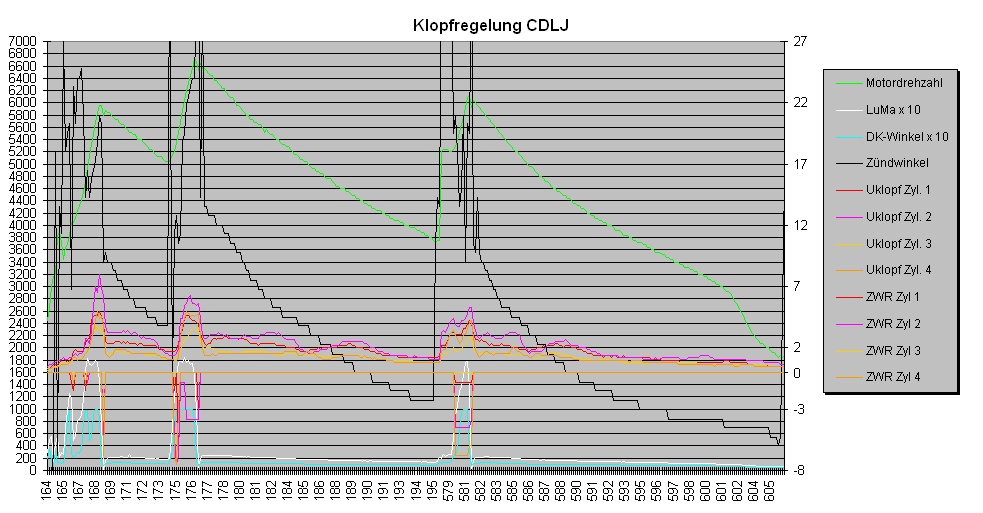

Kindly, MED9.1 provides the MWB26 with all knocking sensor voltages – or, rather, what the MSG assigns to each cylinder based on the signals from the two sensors.
In the diagram, I have shown some Wide Open Throttle (WOT) acceleration phases (engine speed, indicated in green, increases) and the subsequent thrust phases that follow (indicated in green, decreases).
Yellow to purple represent the sensor voltages (peaks upwards), while the Z-axis retractions (peaks downwards) occur only during accelerations.
During the acceleration phases, nothing can trigger the knocking sensor, yet the sensor voltage increases with increasing engine speed. And they are quite different: Cylinders 3 and 4 are always close together, while cylinders 1 and 2 spread upwards and also scatter significantly among themselves.
Even though the software seems smart enough to at least attempt to adjust to the situation (instead of always giving cylinder 2 the strongest and longest injection pulse):
Is this the normal state of the art, or is it a warranty case?
By default, the MWB28 allows you to test the knock sensors. During this process, the engine automatically revs up to 2500 rpm, and then the display shows "System OK."
Logically, the large deviations in sensor voltages only occur at higher speeds.

ulf wrote:
During the compression strokes, nothing can knock.
Ulf has just developed a completely silent engine... icon_rolleyes.gif icon_lol.gif icon_lol.gif
Unfortunately, your statement is simply not correct. The "knocking sensor" not only detects doorbell chimes, but all engine noises (and resonances) from which the doorbell chime signals are filtered out by software.
With that, you should now understand why cylinders 1 and 2 are showing significantly higher readings. Just so much... with a VW TDI, it wouldn't be like that icon_wink.gif.

Jan6K wrote:
...how can one convey this to the friendly person? The vehicle is running, and there are no visible problems during operation...
With that, you should now understand why cylinders 1 and 2 are showing significantly higher readings. Only this much... with a VW TDI, it wouldn't be like that icon_wink.gif
. What specific (front-end) noise source does the CDL have that a TDI doesn't?
Both have a timing belt drive. The chain in the CDL system only connects the two inner wheel ends, and it does so on the transmission side.
The LiMa (likely referring to a starter-generator or similar device) is located on the front of both engines.
Do you mean that equalization nonsense? AFAIK, it's more likely located on the forehead side rather than the coupling side.
Here's the diagram. The upload failed yesterday.
 Zündwinkelruecknahme Polo WRC (Motor CDLJ)
 File size:  22.86 KB
 Viewed:  3200 times
That's where I see the "problem".
Okay... I forgot that the TDIs also come with that ridiculous energy-wasting module... icon_redface.gif
Okay, so your diagrams don't show anything unusual...
