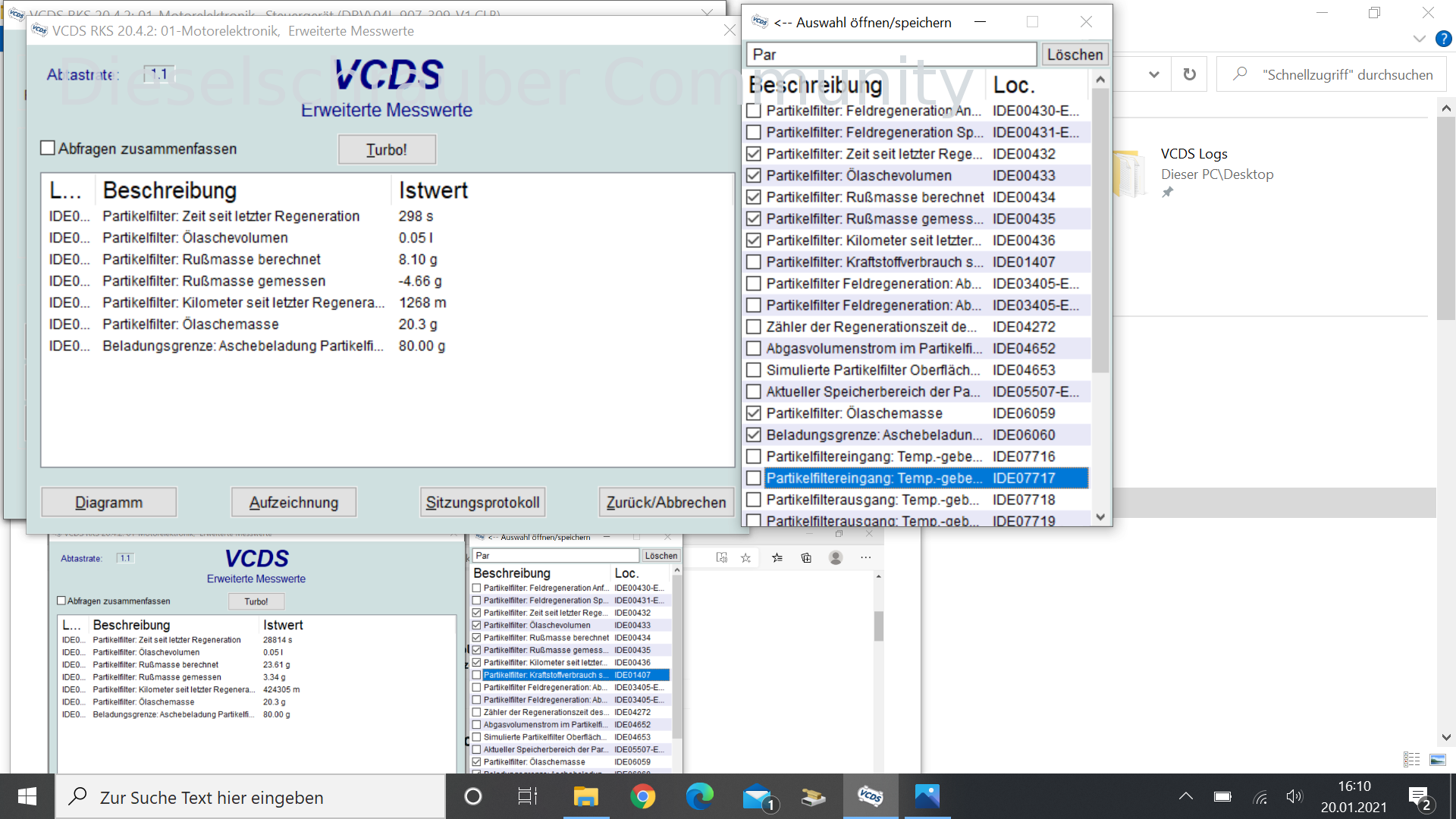

VW Passat B8, 2.0 TDI, 75550 km.
The values were recorded once directly before the regeneration and once 1 kilometer after the regeneration.
 File size:  646.4 KB
 Viewed:  2829 times
