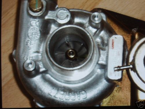

Take a look inside the turbocharger.
Okay, so disconnect the suction hose (made of hard plastic) from the top to the bottom of the turbo (there are 3 10mm screws). Then you can manipulate the shaft (rotate it, feel for axial and radial play) and potentially identify any damage. (You can insert a small digital camera to get a better view).

Post07-02-2006, 11:16    Subject: Turbo defective? Quote
What's up? / What's going on?
"So, you want to spin the impeller, right?"
But only at -10 degrees Celsius with very old 15W-40 oil!
It doesn't tighten properly when you turn it, but you shouldn't need a wrench to tighten it; your fingers (specifically, the small ones...) should be enough to get it into the housing.
That's where they need to go.
