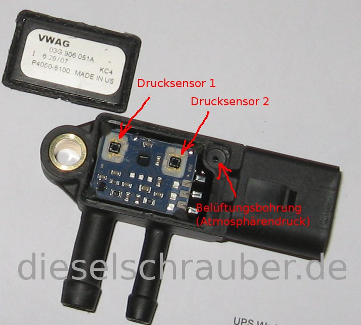

Post26-08-2010, 19:01    Subject: 2.0 TDI differential pressure sensor G450 faulty (Solved) Quote
Internal structure of a differential pressure sensor; not really something that can be repaired.
 Differenzdrucksensor zur Überwachung der Druckgefälles an einem Dieselpartikelfilter.

Post26-08-2010, 20:20    Subject: 2.0 TDI differential pressure sensor G450 faulty (Solved) Quote
TWO sensors?
SSP 336 states "Membrane with piezo elements".

Post26-08-2010, 20:46    Subject: 2.0 TDI differential pressure sensor G450 faulty (Solved) Quote
Yep, each of the connecting tubes ends beneath one of the sensors.
The new G450 differential pressure sensor can then be programmed using VCDS:
- Ignition ON, engine OFF.
- VCDS -> 01 - Engine -> Coding II - 11
Enter the login code from the VCDS tooltip (adjustment for exhaust pressure sensor 1 - G450).
- Ignition OFF.
This process resets the learning values for the new differential pressure sensor.

Post26-08-2010, 22:04    Subject: 2.0 TDI differential pressure sensor G450 faulty (Solved) Quote
Then it must have been changed.
Instead of a membrane that bends due to pressure from both sides, two absolute pressure sensors are used, and the difference between their readings is calculated.
