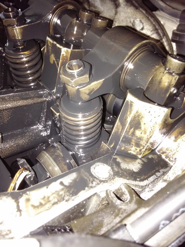

Post02-02-2015, 19:06    Subject: Quote
Okay, once again, thank you to everyone, and especially to AutoserviceViewing profile: Autoservice, klahauiViewing profile: klahaui, and BlackfroschViewing profile: Blackfrosch.
I think I've found the error:
At least one piston is severely damaged; I'm assuming there's a hole. I tried to capture it as best as I could with the camera.

Post04-02-2015, 15:37    Subject: Quote
Am I being fooled, or is your oil milky, like it has water in it?

Post04-02-2015, 19:37    Subject: Quote
Greetings
Adrian

Post02-03-2015, 18:08    Subject: Car is running again, it was actually the hydraulic valve. Quote
Okay, I also want to provide some feedback here:
I replaced the camshaft and pistons with a colleague over the weekend; the car is now running perfectly again. One of the pistons was severely damaged (crushed with a hole in the middle), unfortunately, we didn't take any pictures during the removal, but I can send you a picture of the damaged piston. The corresponding groove on the shaft was already very worn.
