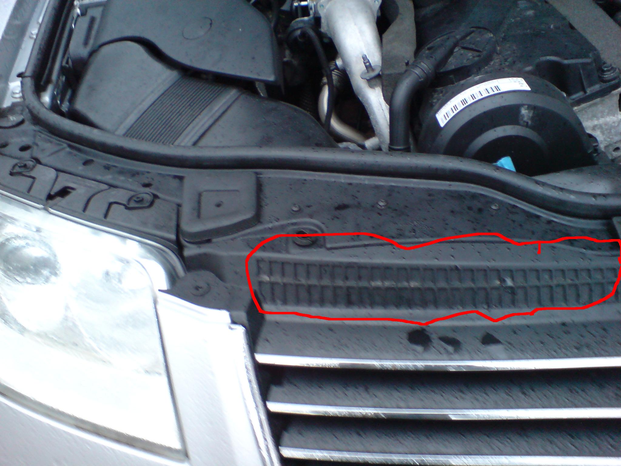

Post15-02-2007, 11:35    Subject: Debottlenecking intake manifolds Passat 1.9 TDI AWX/AVF Quote
As far as I can see, that's how it is. That's why I created this topic. Or maybe I'm blind as a bat.
Attached are a few pictures.
The area highlighted in red shows a 'closed grid'. Behind it is the intake manifold, which can be seen in the 2nd [image/diagram/etc.]. The image should be clearer.

Post15-02-2007, 11:58    Subject: Debottlenecking intake manifolds Passat 1.9 TDI AWX/AVF Quote
Okay, as you can see from the pictures, the area in front of the intake manifold is closed off (with a solid grille). The area behind the actual, open grille is obscured by the radiator/condenser.
It's difficult to say exactly what the airflow is like. Perhaps air is also entering from the engine compartment. In any case, the supply of fresh air isn't exactly abundant - at least, that's how it seems to me. Therefore, it is very interesting to know what other drivers of the 3BG think about it.

Post15-02-2007, 12:50    Subject: Debottlenecking intake manifolds Passat 1.9 TDI AWX/AVF Quote
It's located above the radiator, just like on a Golf, for example, but it's on the other side. The remaining part serves as a splash guard, and it's essential!

Okay, so I'm also chiming in as someone who drives a 3BG and a V6. My intake is the same as yours at the top, except that the closed grille you have is a real grille on mine, so it actually sucks air through. I have no idea why yours is blocked. Now, mine also has an opening in the air filter box, pointing directly downwards, probably towards the wheel well.
"This intake nozzle should be the same as mine. It's attached to the lock carrier and can be removed with 2/3 of the screws. As far as I remember, the nozzle runs above the radiator and definitely does not draw air through the radiator." He probably takes a detour to get air through the grill, but not through that specific grate.
You're not talking about an opening at the bottom, maybe you should check to see if one exists.
So, the process of "de-throttling" for your car might look like this: Install the air filter box (I'm not sure if the top part of the air filter box, which includes the connection for the mass airflow sensor, is the same...) and the grill from the V6 model (or simply open your existing grill). Now you have the problem that it might already be inhaling quite a bit when it rains, which it might not be doing now.

So, as Mr. Antje already mentioned, the V6 version draws air through two intake passages, while the 130 HP PD model only uses one.

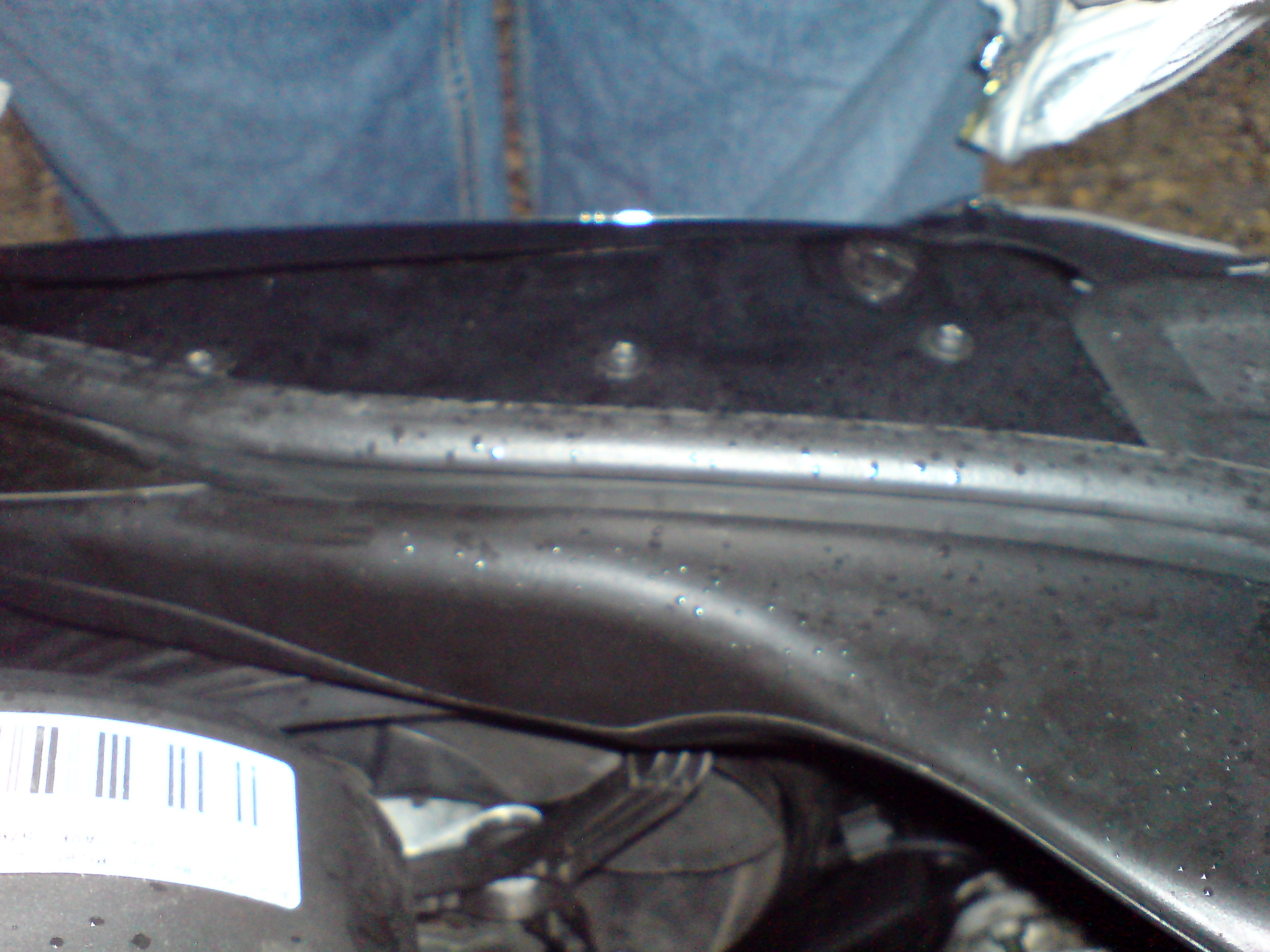

Okay, so I disassembled mine this weekend... it has plastic underneath the upper part of the headlight housing, all the way to the left headlight. It also has holes specifically placed next to the headlight on the front panel. However, it's not a 100% airtight connection.
