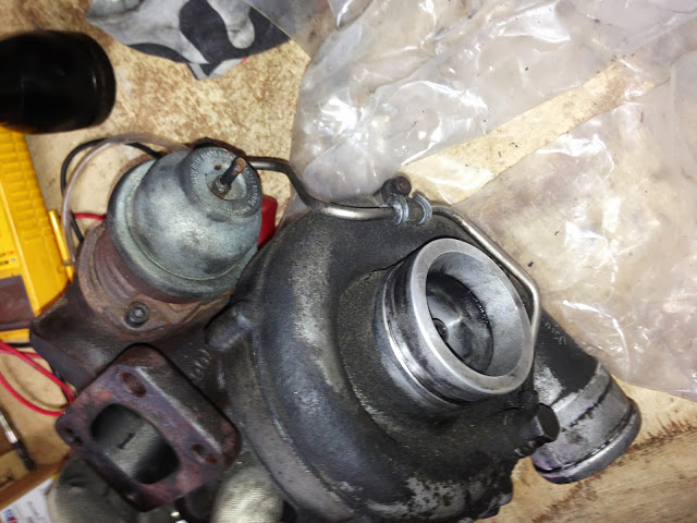

Hello.
I'm currently having a problem with the AEL in my Volvo - it's not producing any power.
Around 2000 rpm, you can briefly feel a sensation of air being compressed, but at 3000 rpm, it completely disappears, and there's no more power. The boost pressure doesn't exceed 0.4 bar (according to the measurement), but 1 bar is required.
Based on this, I suspect there's a problem with the turbocharger itself or its related components. I've already swapped everything around the turbo – from one vehicle to the other, including all the valves, sensors, and hoses – but it didn't make any difference.
The LMM (lambda sensor) has been replaced, and the pump setting has been adjusted. Before that, I checked the timing cam (I was thinking that the timing belt might not have been installed correctly, given all the random markings you see on these engines).
The fact is, the engine was replaced at the Volvo dealership 150,000 km ago. Since then, it's been sluggish, according to the former owner. I estimate it's producing around 80 horsepower.
My suspicion was that the wastegate was somehow stuck - the problem is, I'm not familiar with how it works. For example, with the turbos on gasoline engines, you can directly see a valve that opens. On the turbocharger of the old TDI, you see a "hole" and a pipe. Could someone please explain to me how that works?
However, the valve itself seems to be working, as far as one can tell by listening (it opens when I suck on the hose).
I also removed the intake manifold yesterday - the EGR system is active - but surprisingly, it was quite clean.
One of my suspicions is that the turbocharger may have been damaged during the engine failure back then, but this wasn't detected or found. However, the shaft rotates normally (on the intake side).
It's also the case that you can't hear the turbo at all - you usually hear a slight noise when a new one is installed. Therefore, I also assume that the intercooler system isn't broken - the hoses are fine - but if, for example, the radiator bursts, you should see (oil) and hear it, right?
"Someone might have a tip, especially regarding the function of the wastegate. I already have a replacement turbocharger on my workbench, and I'll be installing it today. Hopefully, that will give me a better understanding of the issue and allow me to resolve it."

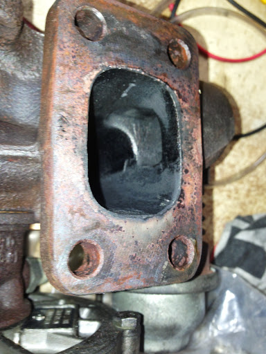

"I replaced the turbo today. Now I understand how it works. Unfortunately, the replacement didn't make any difference at first. I've tried everything – now it seems like the problem might be with the ESP or the injectors. When I use a chip tuning, there's only a slight improvement; I can hear the turbo, but it stops boosting around 3000 rpm."
There's nothing more that can be done.
However, it then becomes very quiet, which is why I suspected from the beginning that the pump was malfunctioning. But the settings are correct.
Could it be that something is wrong with the injection molding machine, or is there a problem with the pump?
I doubt that the pump or the nozzles are the problem, but I've already replaced almost everything else.

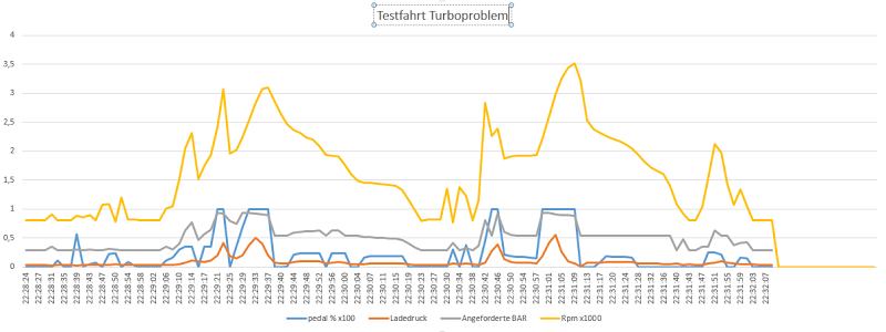

The system requests a boost pressure of 1 bar, but it only delivers 0.4 bar.
The intake manifold and exhaust manifold are clear. The mass airflow sensor (MAF) has been replaced (I have several identical vehicles, and I've already swapped almost everything between them for testing).
The exhaust system itself remains, but the question is: is there a mouse sleeping in the exhaust, or is the catalytic converter clogged?
I also have some nozzles lying around; I'll replace them tomorrow. And the wiring harness on the engine too - it seems there's something wrong with the wiring.
Attached is a test measurement.

"If the exhaust was blocked, I believe the turbocharger pressure would initially appear normal, but then drop off at higher RPMs. It might be beneficial to examine the catalytic converter more closely."

A pressure of 1 bar is requested, but only 0.4 bar is delivered.
The intake manifold and exhaust manifold are clear, the mass airflow sensor (MAF) has been replaced (I have several identical vehicles, and I've already swapped almost everything with a test vehicle).
1. What happens if you disconnect the control hose at the turbocharger housing? Then the wastegate should be closed, and the boost pressure should not be limited. If the boost is still too low, then with a working turbocharger and no exhaust leaks before the turbine, it can only be due to a lack of drive (exhaust flow). }
"Do you observe significant discrepancies between the (high) average fuel consumption reading and the (lower) fuel consumption during nighttime operation? If so, there's likely a bottleneck somewhere between the electronics and the fuel injection system."
Translated on 19-10-2026, 3:33.
