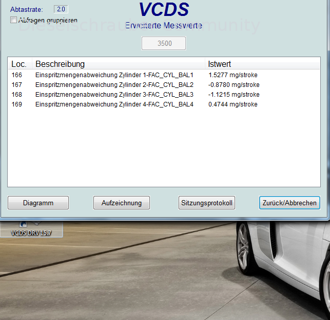

Hello!
"I'm experiencing a problem with my Octavia 1Z 1.6CR CAYC engine: it makes a noticeable knocking sound at low RPMs. It's most audible after shifting gears, when accelerating between 1200-1500 RPM."
There's no noticeable stuttering or loss of power, it's just the rattling that bothers me.
Skoda informed me that the injectors are faulty. I performed a fuel return flow measurement, and all four injectors showed the same amount of fuel being returned.
The values for the idle speed control would be:
1 cylinder, +2 mg.
2 cylinders -0.5
3 cylinders -0.86
4 cylinders + 1 mg.
The first cylinder is out of sync.
I believe the current software version is: 9972.
Address 01: Engine Control Module (J623-CAYC)
Label file: DRV\03L-906-023-CAY.clb
Part number SW: 03L 906 023 AG, Part number HW: 03L 906 023 AG.
Component: 1.6L R4 CR turbo diesel H23 9972.
Revision: --H23--- Serial Number:
Encoding: 00114016032400080000
Operating number: WSC 38940 001 1048576
ASAM Dataset: EV_ECM16TDI02103L906023AG 003011
ROD: EV_ECM16TDI02103L906023A_VW32.rod
VCID: 6BD1975582AA6C66BB-803E
Does anyone have more experience with the injectors?

1 cylinder, +2 mg.
2 cylinders -0.5.
3 Cyl -0.86
4 cylinders + 1 mg
The sum of all offset values always results in zero. Simply take a Screenshot in VCDS or click the "Save" button in the program.

Post20-07-2016, 17:02    Subject: Octavia 1.6 Cayc Nails Quote
Attached is the image.

It results in a sum of 0.00 mg/H. Consequently, the initially reported values were not actually correct.
The values are within the acceptable range. Regarding the noise levels, there were indeed software updates for the 1.6 TDI engines, but your software version appears to be quite up-to-date.
What exactly is the problem, and is there an audio file of the hammering sound?
Translated on 16-07-2026, 15:36.

Post20-07-2016, 19:59    Subject: Octavia 1.6 Cayc Nails Quote
dieselschrauber wrote:
It results in a sum of 0.00 mg/H. Consequently, the initially posted values were not actually correct.
Best regards, Rainer
The engine control unit (ECU) has been updated to the latest software version, and then a small-batch adaptation process will be performed. According to the diagnostic tool ODIS, all injectors are outside of their specified operating range.
I will upload the audio file soon.
Best regards.
Chris.
