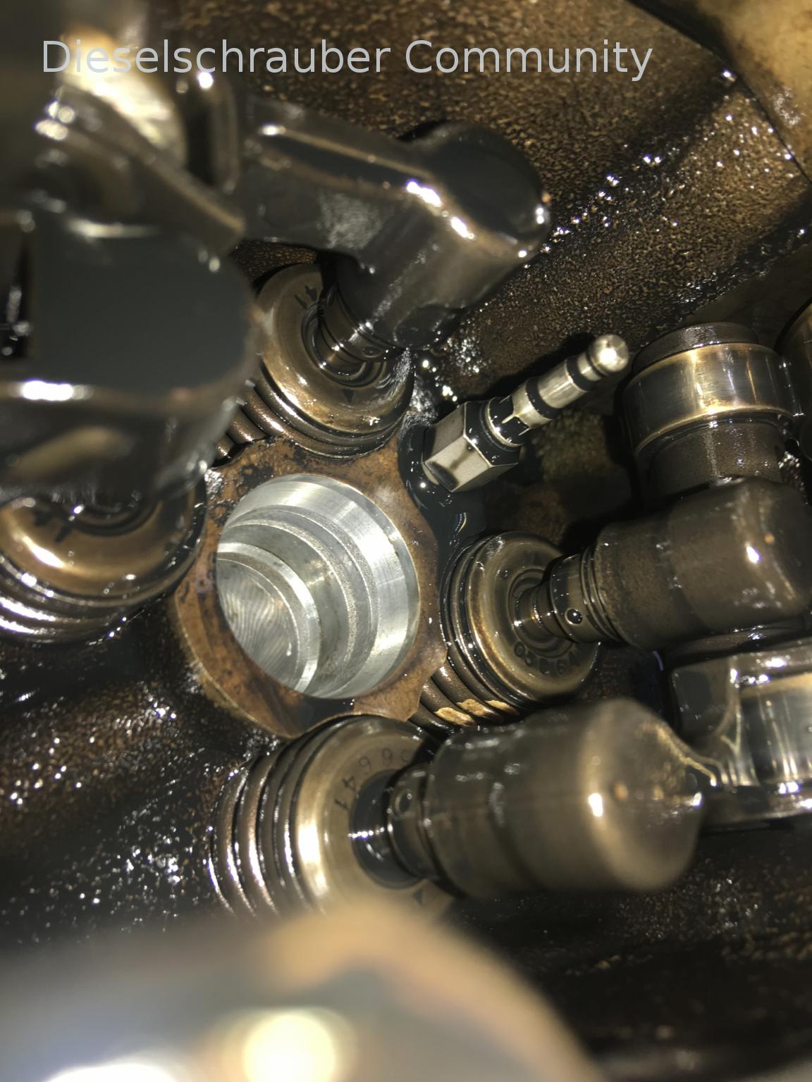

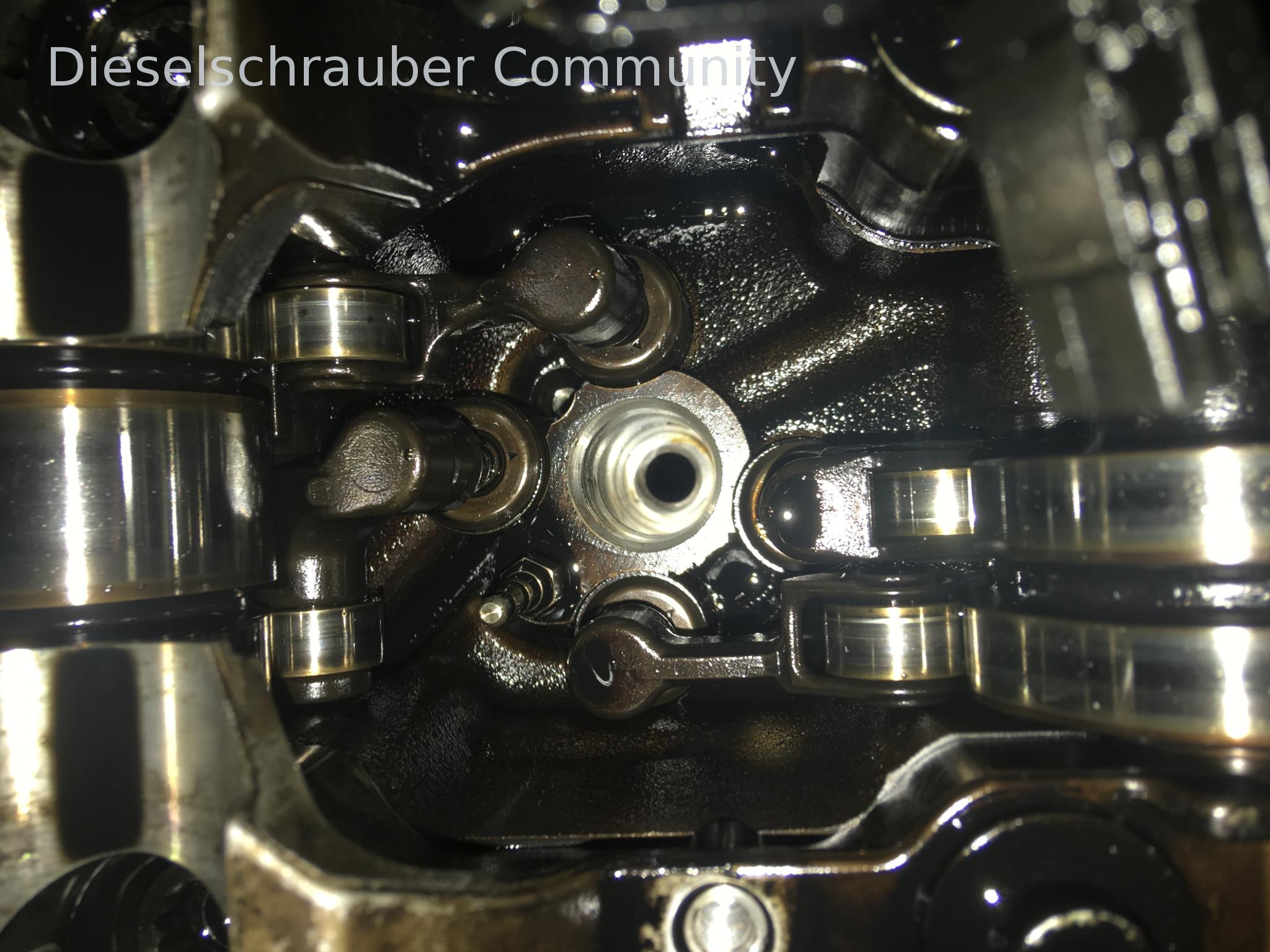

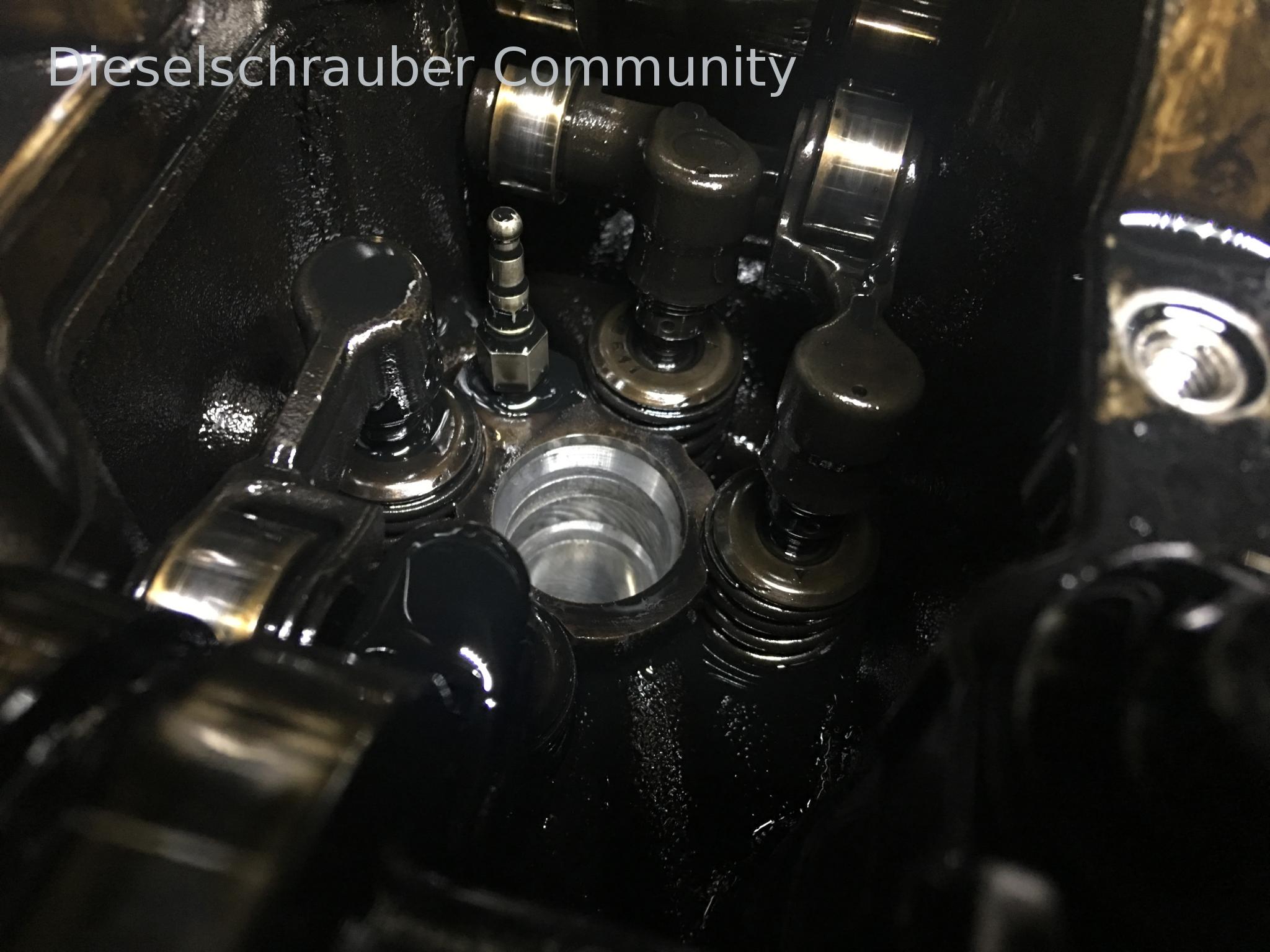

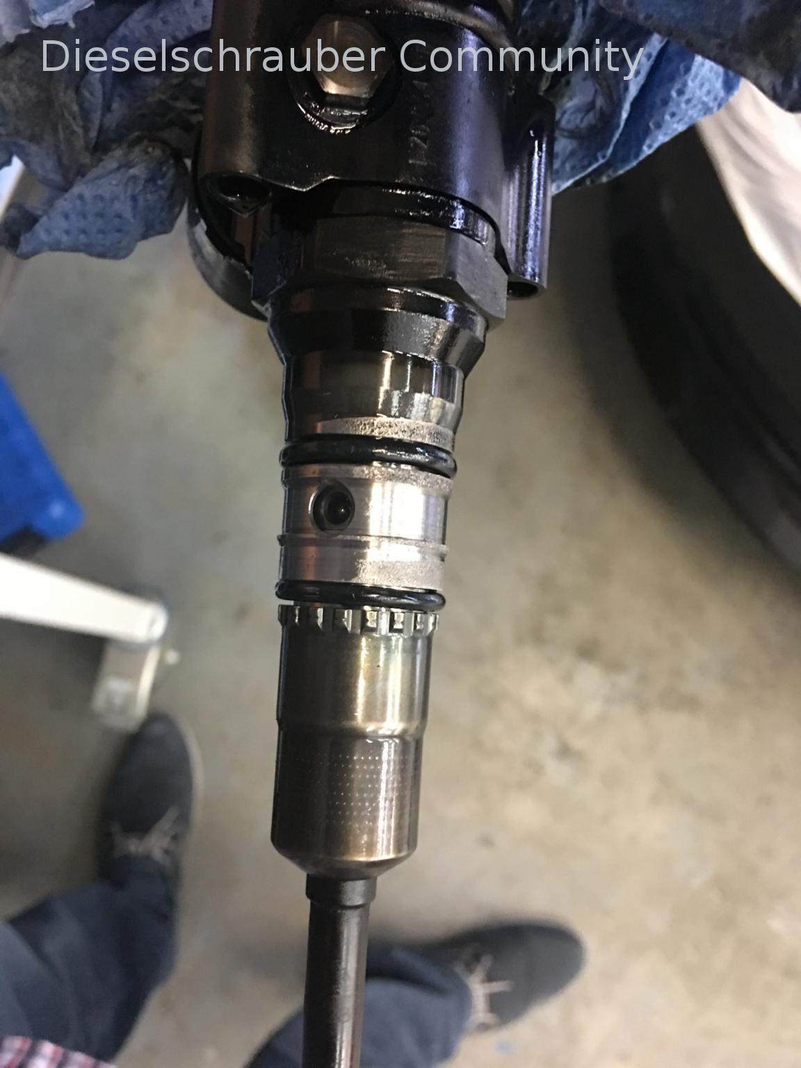

"The error memory is clear, the EGR valve has been checked and cleaned, and the EGR cooler was replaced due to suspected leakage. The MAF sensor readings are correct." Removed the PD elements today... hmm, they look strange. Does anyone have any ideas what the reason might be? (Pictures)
"Do you think the nozzles and the head are finished? Or what do you think?" What is the cause of this wear pattern?
Ah yes, this is what all 4 nozzles look like...

What does the cone in the cylinder head look like, is it oval? Normally, it misfires when the seal between the injector nozzle and the combustion chamber no longer fits properly.
I would have also seen it in the MWB 23.
VCDS

To me, the nozzle looks quite normal. Slight erosion above the first sealing ring, but no significant damage.
I can also see no defects in the piston ring area. At least not in the picture.
You mentioned that the AGR cooler was replaced. Did the engine lose any coolant? Perhaps the problem wasn't the cooler itself, but a hairline crack in the cylinder head. The first 16V cylinder heads, which were not manufactured in Germany, had significant problems.

Specifically, the 16V models with the double thread and conical sealing surface tend to cause more problems because the sealing surface becomes oval, which then leads to these jerking issues.
Please take another look at the valve seat at the top, or take a picture where they can be seen. Or you can rebuild everything, check the idle speed control as @ Hufe suggests, and look at the MWB 23 during acceleration.

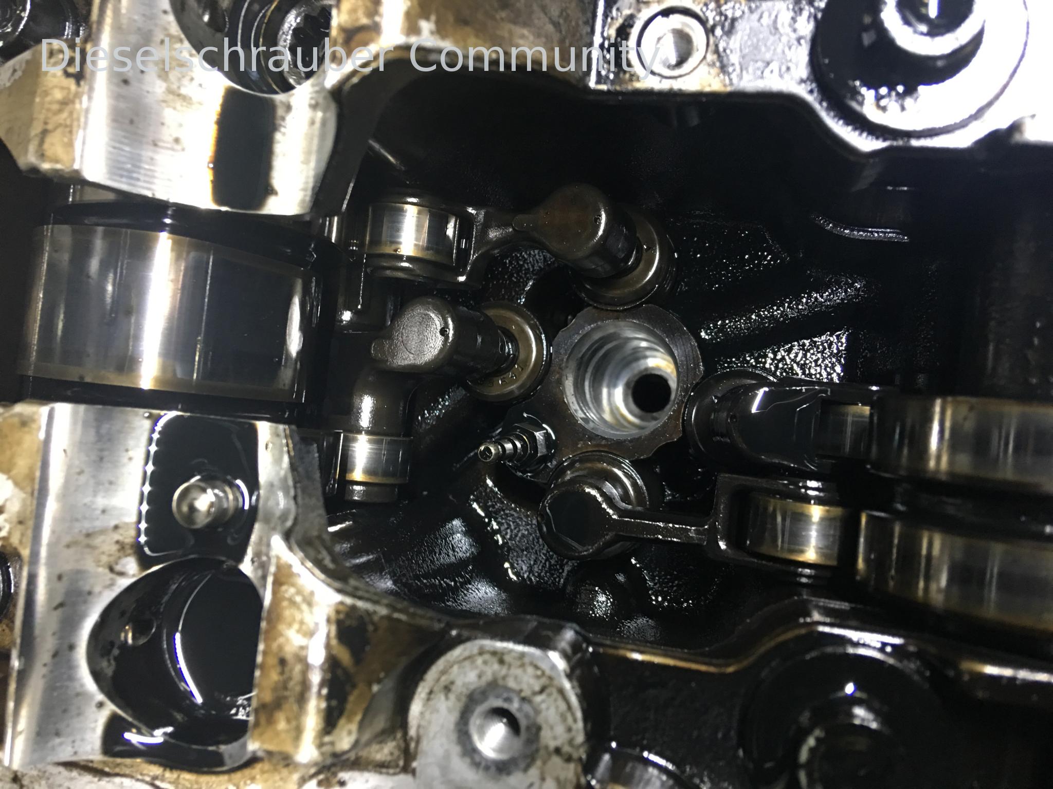

Hi, here are the photos. They're not ideal, unfortunately, but I think you can make out what they are. Could do better tomorrow.

I would say that in the first picture, the seat is no longer perfectly round.
