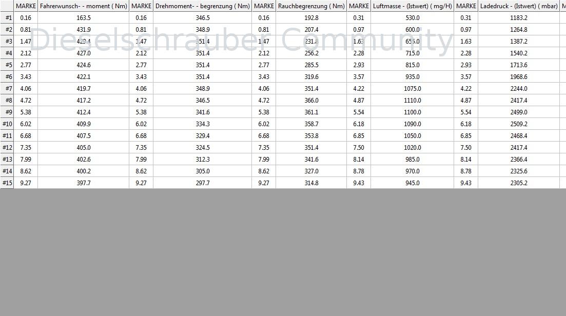

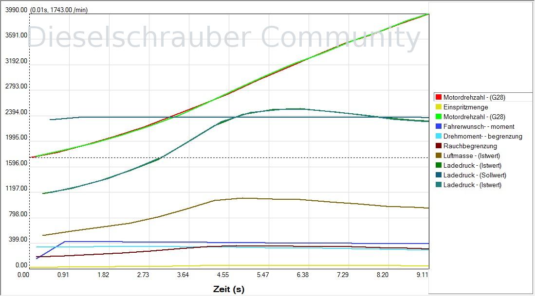

I'm attaching the logs from KDataScope below.
The Passat now has 339,560 km on the odometer. Recently, all the PD injectors were replaced, and the seats were refurbished. The vehicle was shaking violently when accelerating.
My acquaintance then said that the engine runs very sluggishly at low speeds.
Based on the logs, it can be seen that the target pressure is insufficient in the lower speed range.

The overshoot of the boost pressure above the target value at approximately 3000 rpm, followed by an undershoot, could indicate a problem with the variable geometry turbine (VGT) adjustment mechanism of the turbocharger.
Given the currently high ambient temperatures, the build-up of boost pressure in the lower RPM range may be considered "state of the art" depending on the engine, so I wouldn't overemphasize it. Unfortunately, you don't mention the environmental conditions. It was over 30°C in the shade here yesterday.
