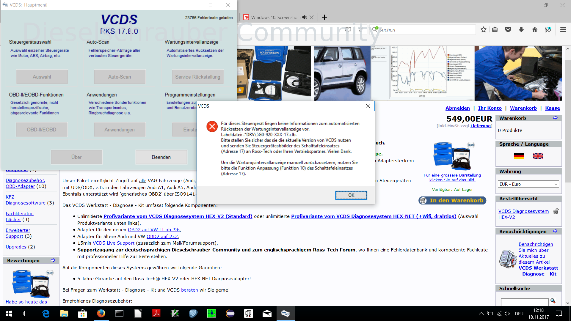

Hello forum,
I'm new to this forum and have only been the owner of the VCDS device from Kaufmann for a few days.
During the initial testing, everything worked well except for reading the service intervals. The German version gives me an error message: "No information is available for this control unit regarding the automated reset of the maintenance interval display," as shown in the attachment.
VCDS SW: RKS 17.8.0
With the English version, it works, at least no error message appears...
Perhaps this is a common beginner's mistake, so please excuse me...
Thank you in advance for your support.

Post18-11-2017, 13:12    Subject: VCDS: Error on Maintenance Interval Display Quote
Please also pay attention to "Similar topics" below, I'm intentionally not posting the link because the information shown below seems not to be recognized.
"Technical articles and guides will be listed first (in black)."
Short version: Click on that and read the instructions on how to do it via the adjustment channels.

Post18-11-2017, 13:43    Subject: VCDS: Error on Maintenance Interval Display Quote
Hello Rainer,
Thank you for the quick response.
The post that you are referring to, I "naturally" icon_smile.gif had already read beforehand, and another post also already deals with the topic.
Perhaps I'm just misunderstanding: It's not about resetting the service indicator, but about the fact that the VCDS assistant isn't showing me the current service data! And this only happens in the German version, not in the English version. The English version at least shows me the essential data.
I just don't understand that icon_question.gif.
Thank you in advance.
Regards,
Long Waldi.

Post18-11-2017, 13:52    Subject: VCDS: Error on Maintenance Interval Display Quote
Okay, have you checked whether the instrument cluster (by directly clicking on control unit address 17) can be accessed via UDS or not?
Unfortunately, you don't specify which specific versions you tested (17.8.0 only refers to the VCDS version, and there are multiple data sets with updated control unit descriptions/labels). Regarding service routines, there may still be slight differences at this time, as the label files are not identical between the German and English VCDS versions, but rather prioritize models that are particularly common in each market.
By the way, there's a data update available for the German (merchant) VCDS in the customer account. Please test that. It's brand new, and there hasn't been a customer notification yet because I'm testing it myself.

Post18-11-2017, 14:53    Subject: VCDS: Error on Maintenance Interval Display Quote
Hello Rainer,
Unfortunately, the control unit with address 17 uses the UDS protocol.
Unfortunately, even with the latest data, I'm still getting the same error message.
"The label file DRV\5G0-920-XXX-17.clb is obviously missing!"
My car: Golf VII Variant, manufactured in 2016.
VCDS -- A VAG/VAS emulator based on Windows, running on Windows 10 x64.
VCDS Version: RKS 17.8.0.1 HEX-V2 CB: 0.4407.4
Data as of: 20171117 DS276.6
"Die Sonne scheint hell, und die Vögel zwitschern fröhlich. Ein leichter Wind weht durch die Bäume, und die Blätter rascheln leise. Es ist ein wunderschöner Tag, um draußen zu sein."
Vehicle type: AU-VW37 (5Q0)
Scan: 01 03 08 09 10 15 16 17 19 20 42 44 52 5F
Address 17: Control panel module (J285)
Label file: | DRV\5G0-920-XXX-17.clb
Part number SW: 5G1 920 751 B, HW: 5G1 920 751 B.
Part: COMBINATION UNIT 304 8311
Encoding: 07A411002380000801086A001400000000000000
Operating number: WSC 00028 028 00068
ASAM Dataset: EV_DashBoardVDDMQBAB 009051
ROD: EV_DashBoardVDDMQBAB_009_VW26.rod
VCID: 270A0B900F6DE6BF3A0-8072
No error codes found.

Post18-11-2017, 17:57    Subject: VCDS: Error on Maintenance Interval Display Quote
And why don't you simply use UDS and the individual channels? The link explaining how to do it is in the technical article...

Post18-11-2017, 18:37    Subject: VCDS: Error on Maintenance Interval Display Quote
Hello Rainer,
The reading process works for the individual channels, which is even more surprising considering that the assistant doesn't work. icon_question.gif icon_question.gif icon_question.gif
Is there perhaps a software bug in the German version of VCDS?
I can live with the solution, but for a quick overview, I'll just use the English version.
Thank you very much for your help.
Best regards,
LangerWaldi.
Translated on 16-09-2026, 9:14.
Posts: 18135
Post18-11-2017, 19:16    Subject: VCDS: Error on Maintenance Interval Display Quote
No, there is no error; it's exactly as the dialogue you posted here shows. Just be patient.
