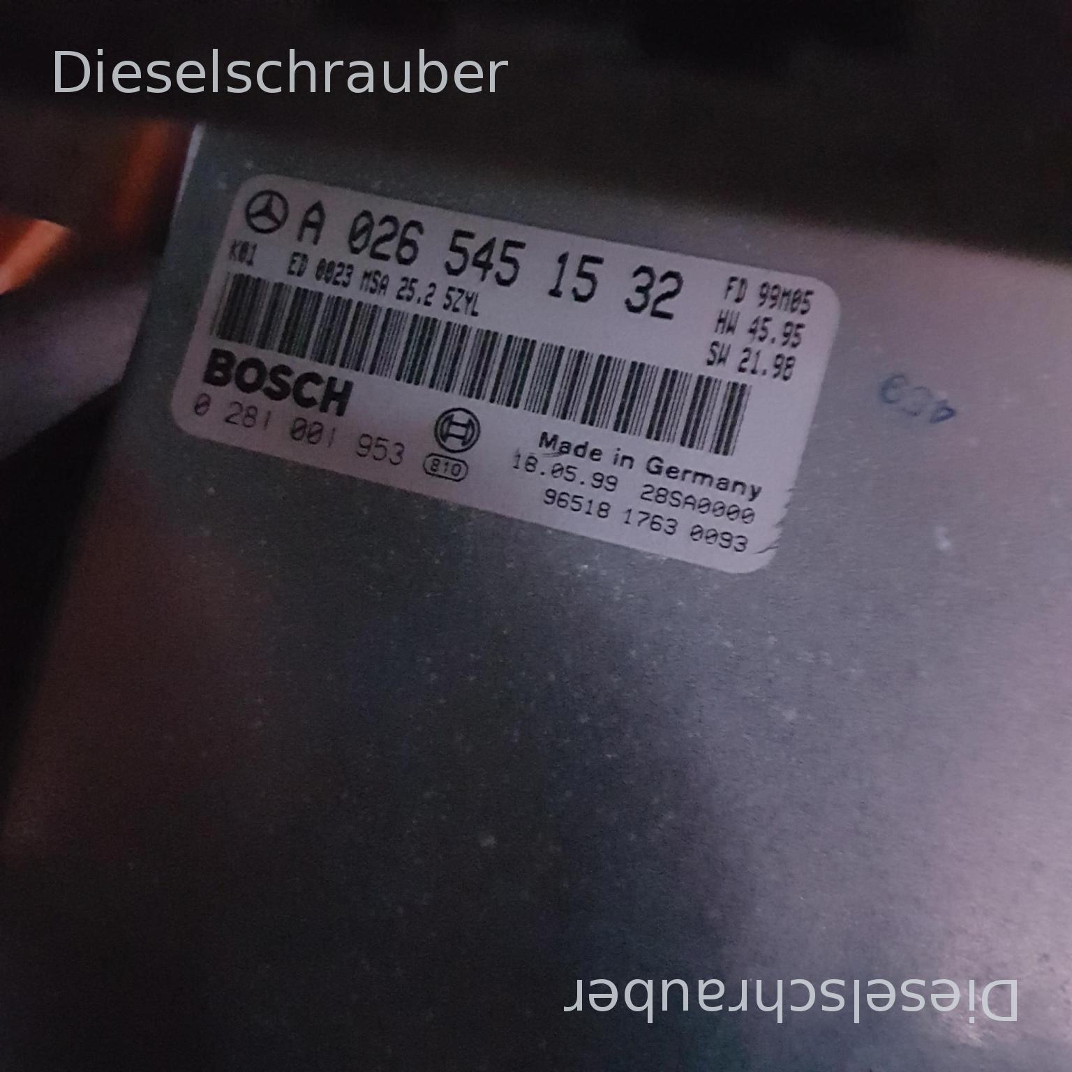

Posting a picture of the control unit here, where all the important labels can be seen, would still be very helpful.

Post29-08-2021, 16:43    Subject: Can I install a motor control unit from a W210 E290 TD into a W461 GDT 290? Quote
Attached is a picture with the identification number.
Thank you.
 Bosch MSA 25.2, Mercedes Benz A 026 545 15 32, Bosch 0 281 001 953
