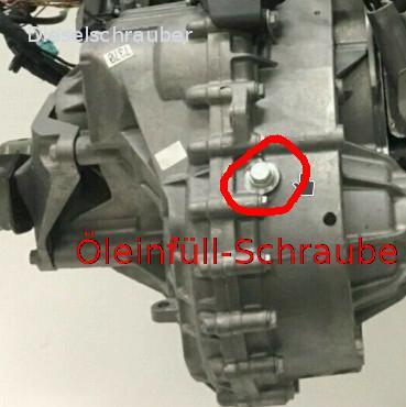

The drain screw is located on the underside of the gearbox. Before operation, it is recommended to check the accessibility of the filling opening.

The fill opening varies depending on the gear type. For the model with the marking SAY, it is located at the top of the rear of the gear. Alternatively, the oil can be poured in through the reverse gear lever after it has been disassembled.
- Oil specifications: Use only oils that meet the VW G 052 171 specification recommended by the manufacturer (e.g., CASTROL Transmax Manual V SAE 75W-80, API GL-4+).
- Quantity: Fill to 2.7 liters to avoid overfilling or underfilling.

- If the filling opening is difficult to access, use a standard oil pump. "The SAY method works without any additional tools."
