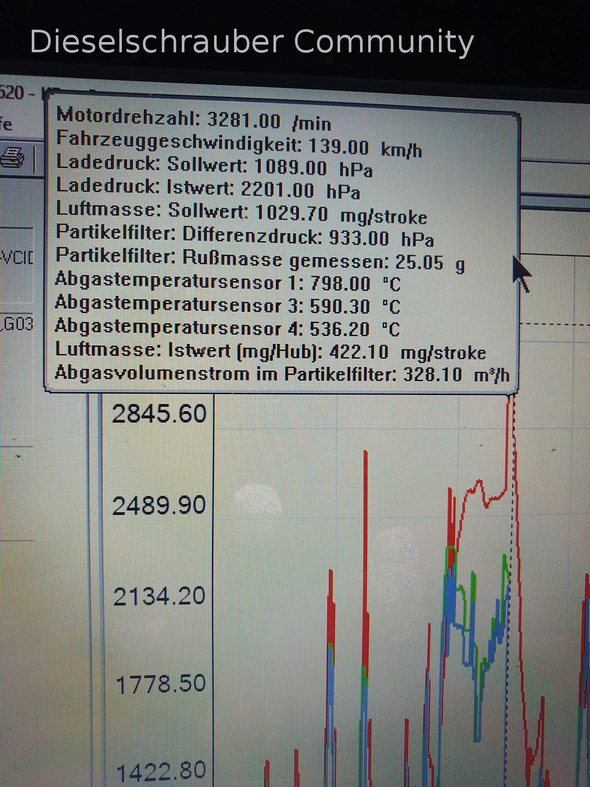

I think I've found it!
At 3200 RPM, the target air mass flow rate is 1029.70 mg/cycle, but the actual value is 422.10 mg/cycle!
The turbocharger is fighting against this, but should have 1.089 bar, but instead shows 2.201 bar. Weird that I'm not getting any error messages!
I have attached an image of the disaster!
That means for me, I should take a look at my car tomorrow, check the hoses, etc.!
Greetings
Ralf

Post01-06-2020, 18:14    Subject: TDI regenerates too often!? Where does all the soot come from? Quote
can you please extract the information from the MSG and post it here:
- Particulate filter: Time since last regeneration
- Particulate filter: Oil volume
- Particulate filter: Soot mass calculated
- Particulate filter: Soot mass measured
- Particulate filter: Miles since last regeneration
- Particulate filter: Fuel consumption since last regeneration
- Field regeneration loading limit
- Service regeneration loading limit
- Load Limit Exceed
- Vehicle distance
- Particulate filter: Oil mass
This provides an overview of the condition of the filter. You can save these values as an (u01 file) selection and access them whenever you need.

Post02-06-2020, 8:28    Subject: TDI regenerates too often!? Where does all the soot come from? Quote
Immediately after regeneration, the "measured" soot value is already back at or at its maximum.
What are the values of the differential pressure sensor when the engine is stationary?
I am aware of the case where the calculated soot mass is significantly higher than the measured value. This can lead to frequent regeneration, and this process ends when the smaller value approaches zero, without the corresponding higher (calculated) value also being correspondingly low.
If possible, could you please record a regeneration using the data above? There is also a status bit for the regeneration status.

Post03-06-2020, 8:04    Subject: TDI regenerates too often!? Where does all the soot come from? Quote
He also did that at the beginning!
I bought the car three years ago with 126,000 km on the odometer. It was a company car for an employee. Now it has 197,000 km on the odometer. Mileage: 30,000 km per year, with very few trips under 40 km on country or main roads.
Maintenance up to 126,000 km at authorized service center, thereafter by myself!
No special incidents in the last 70,000 km!
Hello
Ralf
Für mich gibt es keine Alternative...
VW Tiguan 5N 2,0 TDI 4Motion mit DSG
(125TKM)
Motorcode: CFGC /Bj.2014
VW Sharan 7N 2.0 TDI mit DSG
(254TKM)
Motorcode: CFFB /Bj. 2014
Joined: 06/22/2005
Posts: 4618
Karma: +1336 / -0   Thank you, like it!
dieselschrauber likes this.
Post03-06-2020, 8:50    Subject: TDI regenerates too often!? Where does all the soot come from? Quote
It's just speculation, but if a particulate filter is full (ash loading), then
- if the differential pressure (becomes) too high,
- regenerates the DPF very frequently,
- The exhaust gas flow is reduced due to backpressure, and consequently, the boost pressure and air mass (this is noticeable at high target values).
The ash loading value is a variable calculated value.
