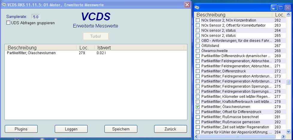

"Now my question is, I want to retrieve the value of the ash mass. My car no longer has a catalytic converter. Car: Skoda Octavia 8/12 CFHC."
We couldn't find it in the list of expanded MBWs.
Is there a different term for that now?

Search for "particulate filter" icon_wink.gif.
In "older" engines, the ash content is measured in grams, while in "newer" engines, it is measured in liters.
0.02 liters is equivalent to 20 ml, and for this engine in the A3, 175 ml is allowed. After that, the DPF must be cleaned or replaced.
Please enter the values for assessing the fill level here.
CFFB engine (2.0 TDI CR, 103 kW), 46,000 km.
 Aschevolumen in den Erweiterten Messwertblöcken mit VCDS.
