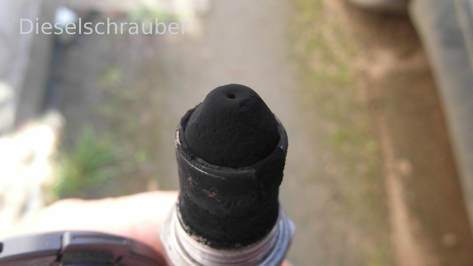

Hello, my old boat is having problems again. In addition to some other odd issues, now it's the engine. When I bought it, I actually hoped that the engine would be mature enough to have fewer problems than my other two "Methuselahs" (referring to old boats).
Here's the translation:
"To the point: it's an A5 Cabrio, 3.0 TDI, manufactured in 2015, with a CKVC engine producing 248 horsepower."
He's been sounding a bit rough for a few days: I'm getting some error messages from the engine control unit (ECU), like "lambda sensor signal too slow," etc. I've attached the engine log below. In another post, I saw that the lambda sensor might be clogged with soot. I haven't found any external errors yet.
My main question: what measurements could I take to make targeted progress?
I also read the readiness data, and there are corresponding errors there. It might also contain additional information (see attachment). Unfortunately, it seems that the text string in these windows cannot be copied, and the windows cannot be enlarged, which makes them difficult to read.
Any other suggestions? I would gladly take it...

Post06-08-2024, 9:39    Subject: update Quote
Okay, after a long time, I had to deal with this problem again. Previously, I had tried cleaning the oxygen sensor, and it had been running reasonably well recently. Now, the check engine light is on again, with the same error code: 0133 (oxygen sensor signal too slow, or similar). Deleted and good for 1 week, then it reappeared: now I've removed the probe again and cleaned it because it's clogged again.
My question: How do you assess the amount of soot shown in the picture? Too much or normal?
If there's too much [something], the question arises: why? Or has it always been like this since the mandatory software update? After all, they supposedly changed the position of the probe in the catalytic converter to a location where it's supposed to get less dirty... It could be an indication that Audi now considers this to be "normal." "Vorsprung durch Technik" icon_cry.gif
 normal?
 File size:  230.76 KB
 Viewed:  671 times

Post07-08-2025, 20:50    Subject: 3.0 TDI Problems: Lambda Sensor/Oxygen Sensor Quote
It's been a while, but maybe this is interesting for others. My spark plug looked much better after almost 300,000 km on the 2.7 BPP engine without a DPF. Smoky, but all openings are clear.
Gruß Christian
