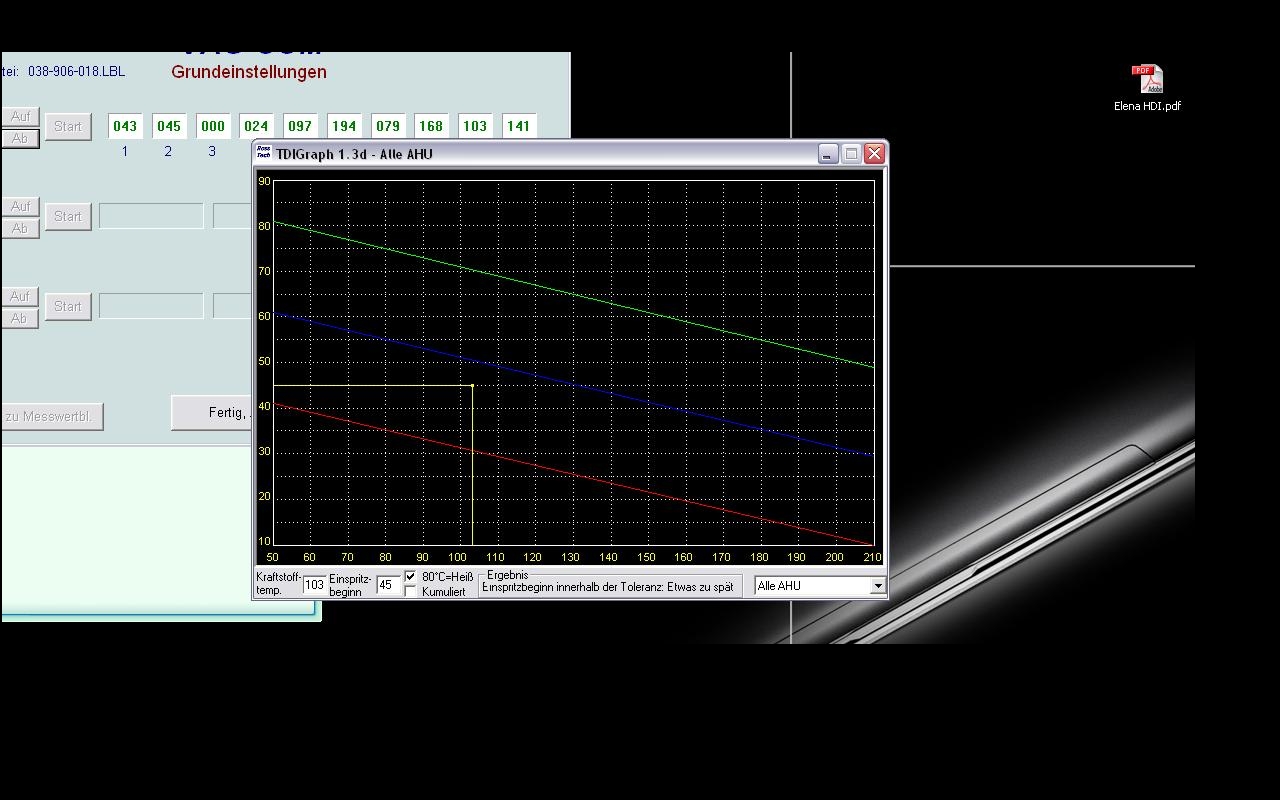

I once tried to drain the diesel fuel filter.
Weird, no water...
Then I also checked the injection timing.
is almost okay.
I'm not sure if there's anything else I should adjust.
What do you think?
See image.
is almost okay.
The start of the spray is fine; I wouldn't change anything there; nothing at all.
When you described the problem, I initially thought it might be related to misaligned valve timing, such as what could happen with a loose pulley or a loose central nut. But the graph actually suggests the opposite.

Why would you set an AHF (air handling unit) according to the AHU diagram?
I'm not sure, but the diagrams and the resulting accuracy of the settings may not necessarily match, especially since the AHU has 90 horsepower and the AHF has 110 horsepower, and therefore they have different injectors... they also have different fuel injection pumps.

@DM.
I thought someone would notice.
Unfortunately, I don't have the latest software on my laptop.
That's why the diagram isn't entirely accurate.
Rainer once posted something of his online.
I also included the values there for comparison.
It looks the same in terms of spacing.
