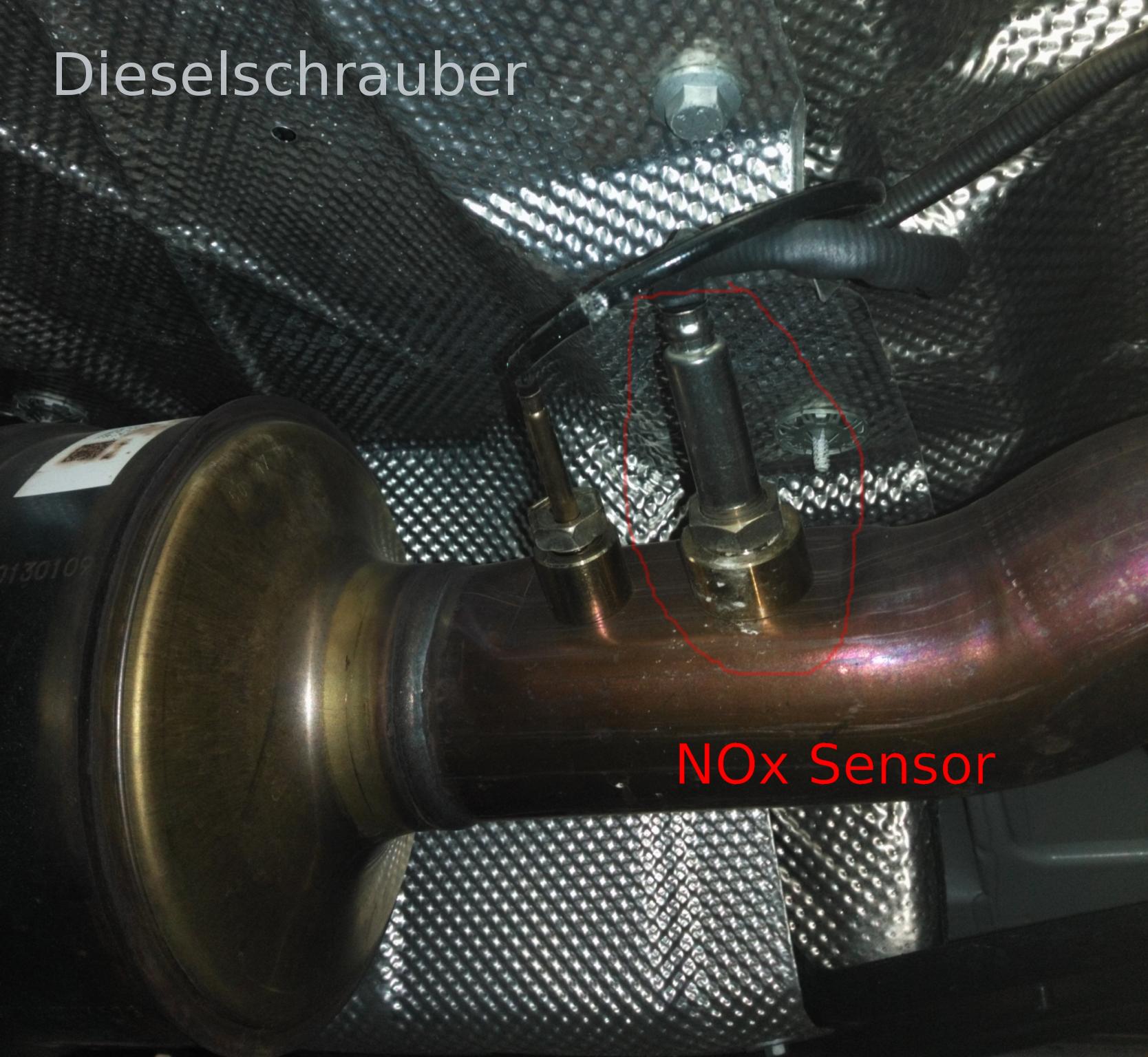

https://community.dieselschrauber.org/it/viewtopic.php?t=30407
 NOx Sensor, Verbauort am VW T6 2.0 TDI
