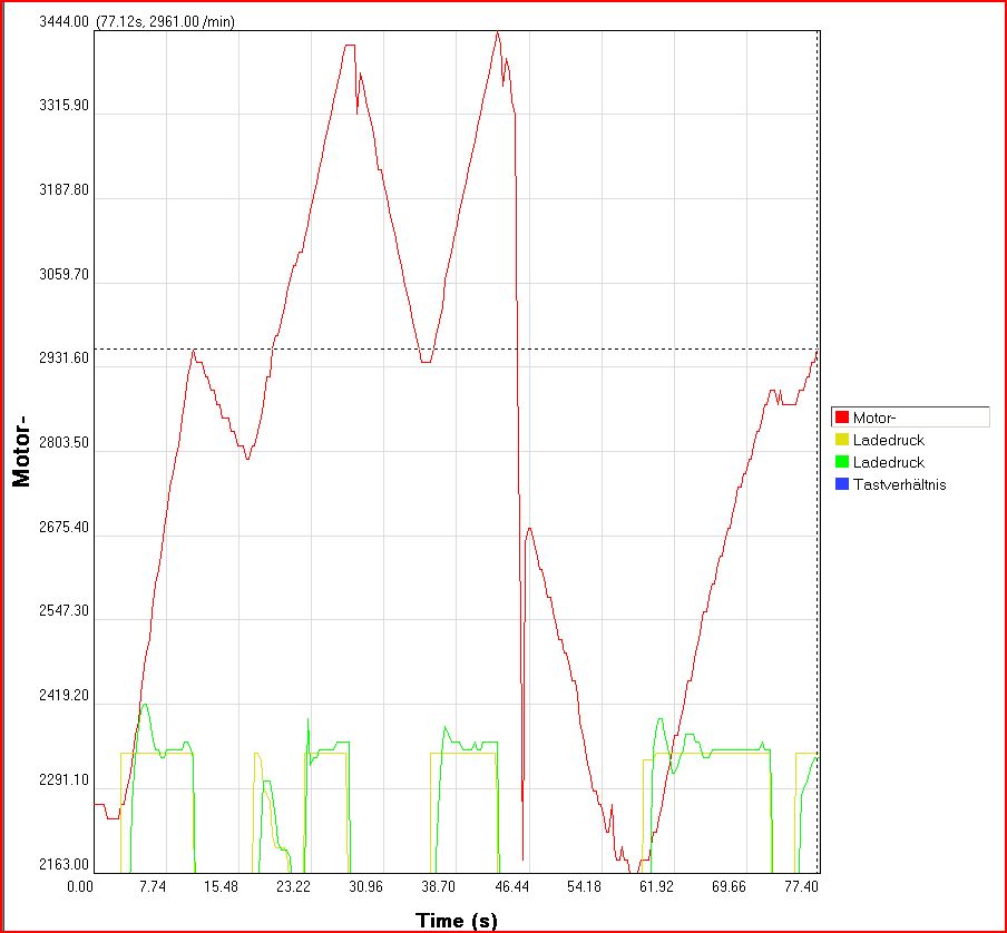

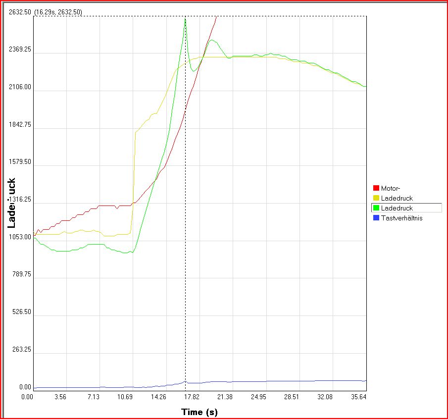

see:
/viewtopic.php?t=18548&start=0&postdays=0&postorder=asc&highlight=&sid=c1e10fc71fd890128504261b0b8f8d42
Boost pressure, over and under. Undercut at
ASZ series, upgraded with new VTG (Variable Turbine Geometry) turbocharger, mass airflow sensor (MAF), and magnetic valve for the lambda sensor.
 Vollastbeschleunigung im 4. Gang
bei 1970 U/min 1,68 Bar IST zu 1,356 Bar SOLL (Umgebungsdruck 949mbar)
 File size:  82.21 KB
 Viewed:  708 times
 abwechselnd Volllast und Teillast
 File size:  93.09 KB
 Viewed:  824 times
LOG-01-004-003-008.xls
 MWB 4,3,8 von 1000-4100 U/min Volllast
