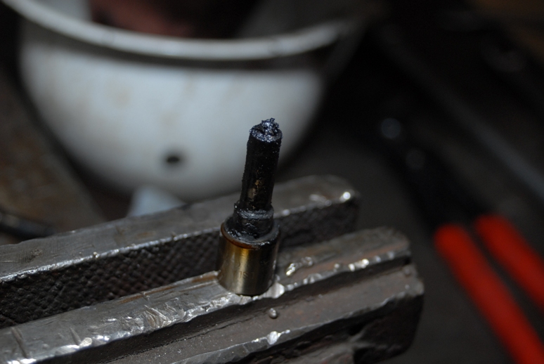

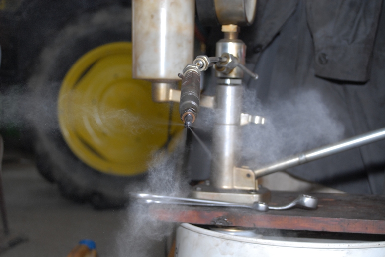

My Audi 80B4 1Z, with approximately 240,000 km, had a "problem" with cold starting (glow plugs were fine), produced a cloud of smoke, and made a knocking noise, etc.
As can be seen in the attached images, it's no surprise that there was also spatter and carbon buildup (all 4 pieces looked the same).

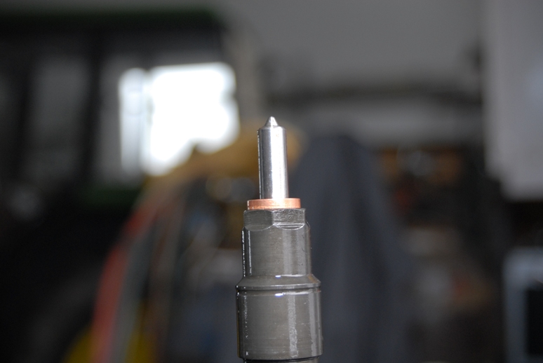

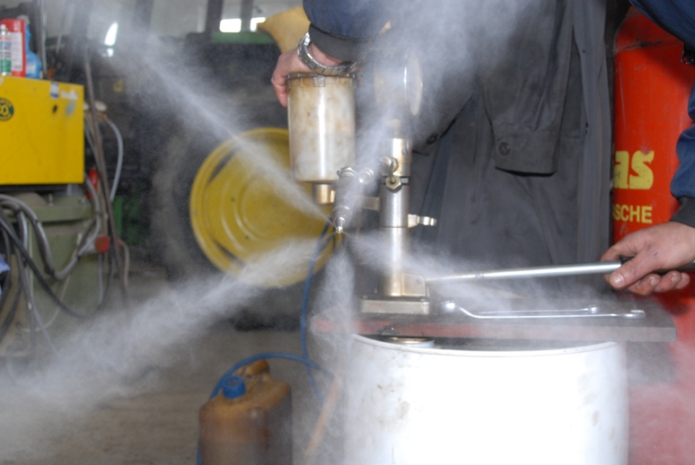

The 0.2, 5 size injectors were installed, the car is almost unrecognizable, there is no smoke, only the typical diesel knocking sound, the performance is noticeably higher while simultaneously having less fuel consumption icon_biggrin.gif, approximately 0.5 liters per 100 kilometers.
I can only recommend it to everyone; those few euros are always worth it compared to replacement nozzles. icon_razz.gif icon_razz.gif
 so sollen sie aussehen

 so sehen Düsen nach 240.000 km aus (kein pöl oder biodiesel)

 Spritzbild nachher

 Spritzbild vorher
