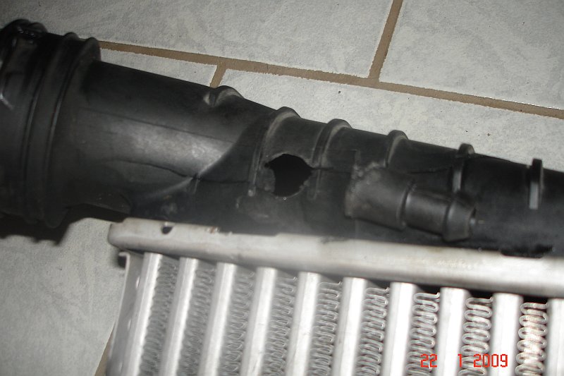

Post24-01-2009, 17:31    Subject: LLK Scrap: What Now? Quote
Hello everyone.
I've already cleaned everything thoroughly.
This oil and soot mixture is also disgusting.
And these quick-release mechanisms certainly aren't the ultimate solution.
They're leaking everywhere.
I have an oil stain on my undercarriage that's about the size of my hand. new_cry.gif
I was just concerned that he might have inhaled some crumbs.
Although I haven't found any wilting anywhere.
Neither in the oil residue from the lubricating fluid nor in the pipes.
I'm just hoping for the best.
Thank you.
Here's a picture of the LLK.
 File size:  81.27 KB
 Viewed:  1496 times

teileklaus
Avatar-teileklaus
Joined: 12/30/2006
Posts: 2643
Karma: +12 / -0   Thank you, like it!
Location: Obrigheim
2005 Volkswagen
Post25-01-2009, 13:27    Subject: LLK Scrap: What Now? Quote
The quick-release fasteners (brackets) can also be replaced icon_rolleyes.gif.
Gruß, der Teileklaus
Fiat 500, Einkaufswagen
