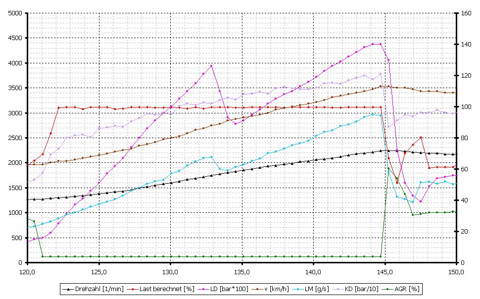

Boost pressure and air mass fluctuations.
Last = Load calculated by the MSG.
LD = Boost pressure.
LM = Air mass.
KD = Fuel pressure.
AGR = Exhaust Gas Recirculation rate (only a control signal for the AGR valve).
