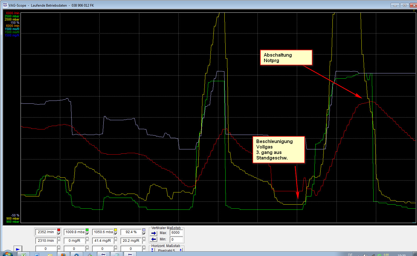

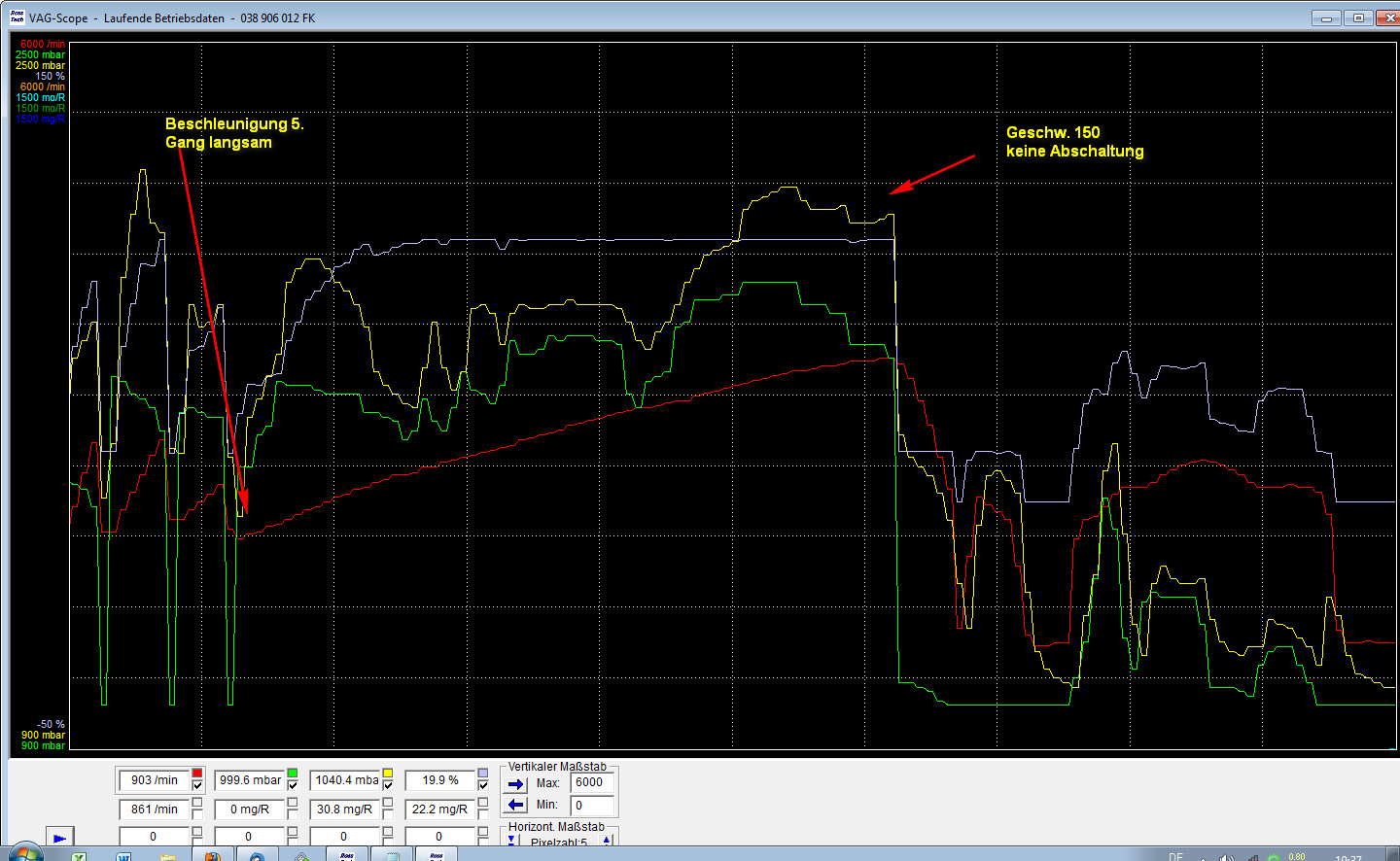

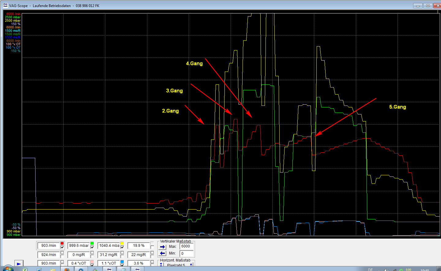

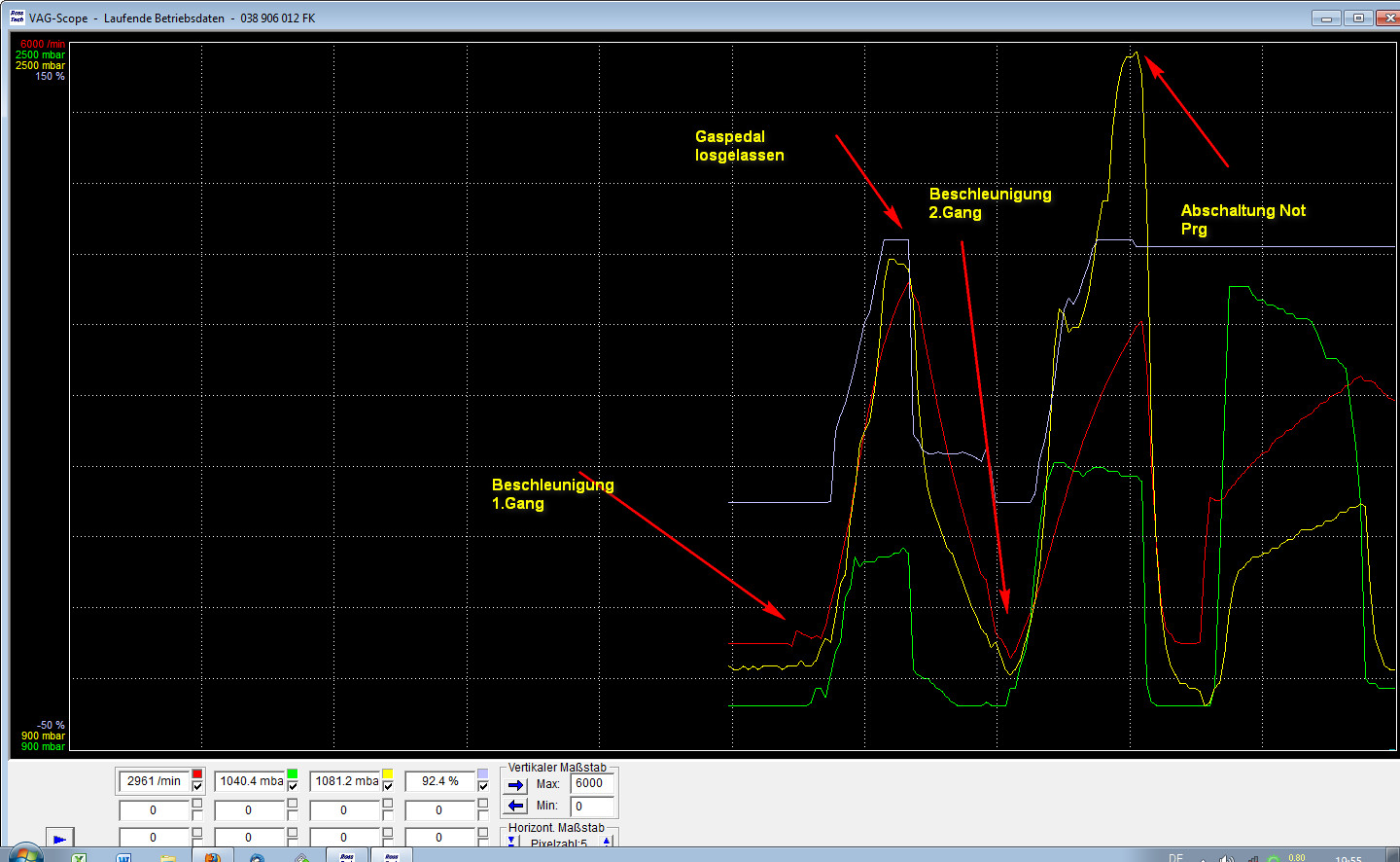

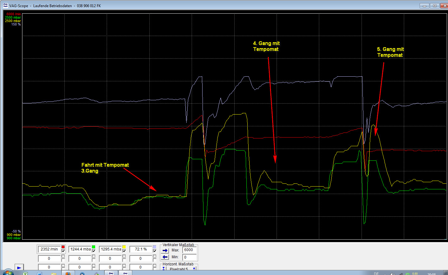

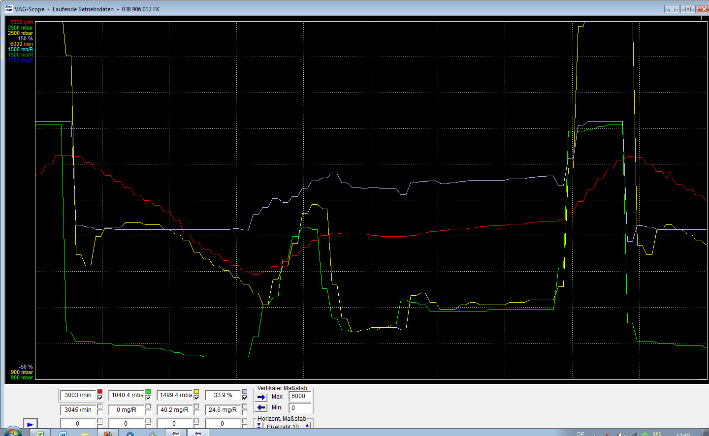

Here are the scope values. Recorded again today.
Red: Engine speed.
green: Target charging pressure.
yellow: Actual boost pressure.
gray: duty cycle of the boost control valve.
(Measurement block 11)
For 2 of the images, I have recorded the ignition timing values.
[/img]
