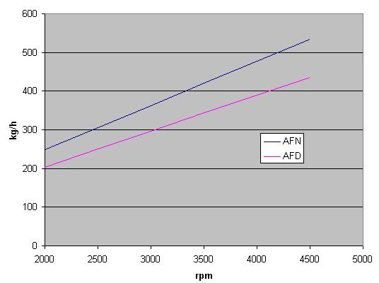

I'll create a diagram.
AFD: 775mg/dose cylinder filling and 17.5 kg/h purging losses.
AFN: 950mg/stroke and 21 kg/h fuel consumption due to the slightly higher boost pressure.
Two estimates of the air mass flow rate are obtained, neither of which accounts for a decreasing cylinder filling mass, which we would expect at higher speeds (due to volumetric efficiency).
The 'sink effect' determines the zero point of the two lines.
and the different cylinder filling masses determine the slopes of the lines.
Best regards, Ernst.
Two estimations of the air mass flow emerge, without a decreasing cylinder filling mass, which we both expect at higher speeds (due to volumetric efficiency).

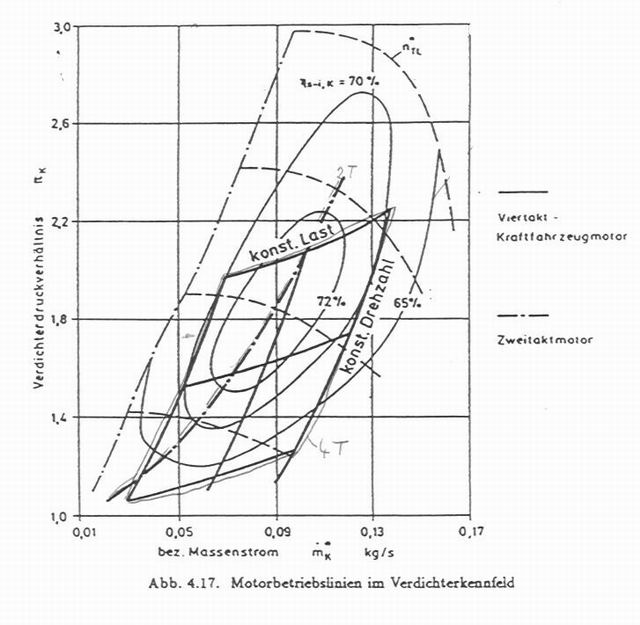

"You're right. And if we were to adjust the AFD's performance graph based on the delivery rate, bringing it down to match the original graph's value (approximately 10 kg/h at 3400 rpm), and apply the same adjustment to the AFN, we could arrive at a well-informed estimate."
After that, the AFN draws approximately 450 kg/h of air at 4000 rpm and approximately 510 kg/h of air at 4500 rpm, which translates to 7.5 kg/min and 8.5 kg/min respectively, both at a boost pressure of 1 bar (P2C / P1C = 2.0).
If this information is entered into the load characteristic field of the initial post, both operating points will still be within the zone of >76% efficiency.
It would also be interesting to see the slope of a line that could be used to describe the relationship between mass flow and charging rate, starting from these points.
I believe it would run slightly flatter than the assumed central axis of the 76% "oval" and extend towards the upper right, exiting the map at a pressure ratio of approximately 2.3, which corresponds to a boost pressure of 1.3 bar.
That is to say, 1.3 bar at 4500 rpm should be the absolute maximum (without any remaining reserve icon_exclaim.gif) that can be imposed on the VNT 15 turbocharger on a 1.9 TDI engine.
I believe it would run slightly flatter than the assumed central axis of the 76% 'oval' and would exit the characteristic curve at a pressure ratio of approximately 2.3, which corresponds to a boost pressure of 1.3 bar.
'Yes, it would look something like that. I've attached a sample image below. It shows how the motor's characteristic curve, defined by speed and load, would demand power from the compressor... but it's just a conceptual image and not a real one. So, don't be distracted by the curve shapes; who knows what kind of engine the designer had in mind.'

Since my assessment seems to be correct, I've added the operating point of an 81 kW TDI at 4500 rpm to the initial diagram, along with an approximate indication of the "trajectory" of that point with an increase in boost pressure.
At the normal rated speed of 4000 or 4150 rpm and normal boost pressure, the operating point would be approximately vertically above the point of 7.7 kg/min, also lying on the compression ratio line of 2.00, according to IMO.
Then, under normal pressure and 4500 rpm, the turbocharger reaches just under 140,000 rpm; at 1.2 bar, it reaches 152,000 rpm, and at 1.4 bar, it reaches 162,000 rpm, nearing the point of collapse with no margin for partially clogged air filters, overboost, etc. - if one interprets the outer edge of the performance curve in that way. icon_question.gif
