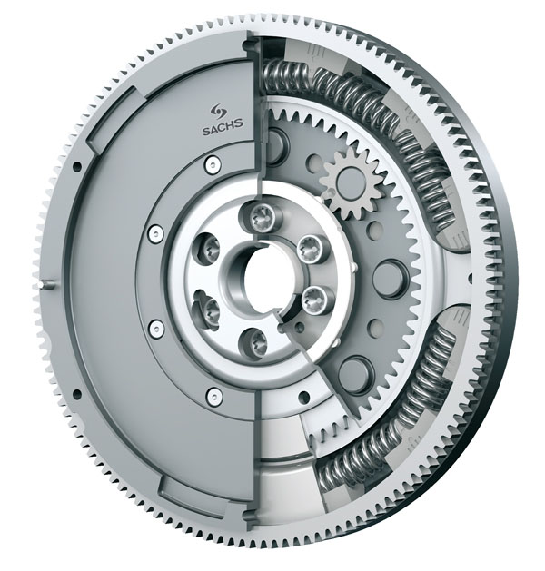

Okay, the gearbox is out, and the dual-mass flywheel is still attached to the engine.
The ZMS (presumably referring to a clutch component) has been defective for approximately 60,000 km. The friction plate is now making contact with the flywheel.
roughly twisted and tightened.
The holes no longer aligned with the screws.
Using a hammer, you can rotate the friction plate in 1/10mm increments, but that doesn't seem like a very good approach for the motor.
Does anyone have any ideas on how to disassemble the ZMS?
Is it worthwhile to drill out the (6?) alunite deposits that are currently visible?

"I would remove the engine and lubricate the dual-mass flywheel (DMF) with WD40, then leave everything as is. Of course, that's not an option without a second car. You could try drilling out the rivets; if it's broken, it's broken, and the worst that can happen is nothing changes."
The ZMS (presumably referring to a component with a damping mechanism) can only seize up if the grease has leaked out, the springs are broken, or something is jammed inside.
I also think that the crank mechanism is not happy with the "fäustel" variant.

"Rivets can be drilled out quite well. The disadvantage would be that there is likely still a considerable amount of tension on them. This could potentially cause the drill bit to get stuck and then break. In this case, the rivet heads could also be cut across with a thin flexible disc. Usually, they will still hold reasonably well, but they will break apart with a simple hammer blow. The small amount of force required usually does not pose a risk to any components."

"In my engine (AFN from Golf 3), the inner part of the clutch disc, where the holes are, was only connected to the outer part by bridges. Only the outer part was blocked."
We cut away the supports, then it was very easy to rotate the part from the inside and unscrew the scrap metal.

Okay, I need to quickly type a response!
The old ZMS is out, and the new one is in.
Die Alunieten sind aus Stahl und es bringt nix, man bekommt nur die Reibplatte runter. The rest.
is fixed.
Okay, so I've removed as much material as possible from the bridges between the screw holes, and then...
removed the "star" from the center.
After that, access to the screws was unrestricted.
