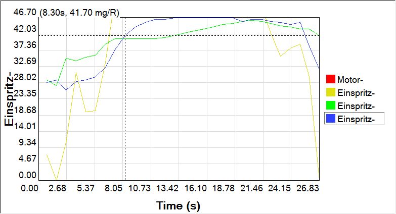

Post29-09-2011, 17:46    Subject: AEL Performance Issues: Troubleshooting Guide Quote
Okay, I took it for a spin and fully accelerated in the fourth gear, starting at 1200 RPM.
I logged data block number 8!
Up to 1800 RPM, the smoke limit determines the fuel injection amount.
Starting in 1858, UPM takes over the torque limitation function.
See the graphic:

Posts: 18119
Post29-09-2011, 18:05    Subject: AEL Performance Issues: Troubleshooting Guide Quote
Okay.
