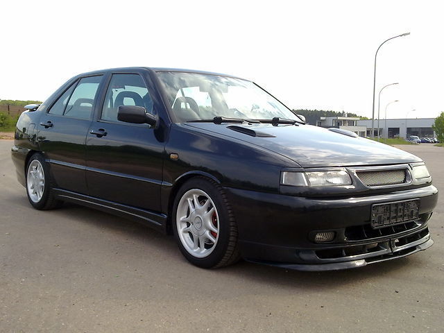

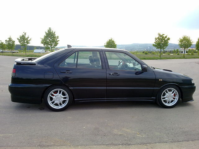

Here's my new acquisition...
Seat Toledo TDI, year 1998.

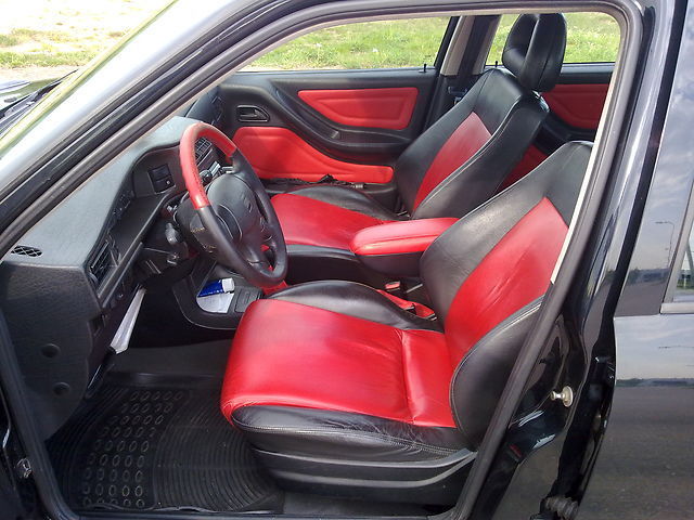

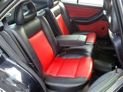

Fully equipped until the very last day...
Leather upholstery made by a saddlemaker, with heated seats.
Climate.

15-inch AZEV summer alloy wheels.
15-inch OZ winter alloy wheels (look like ATS Star).
Front of the Cupra.
