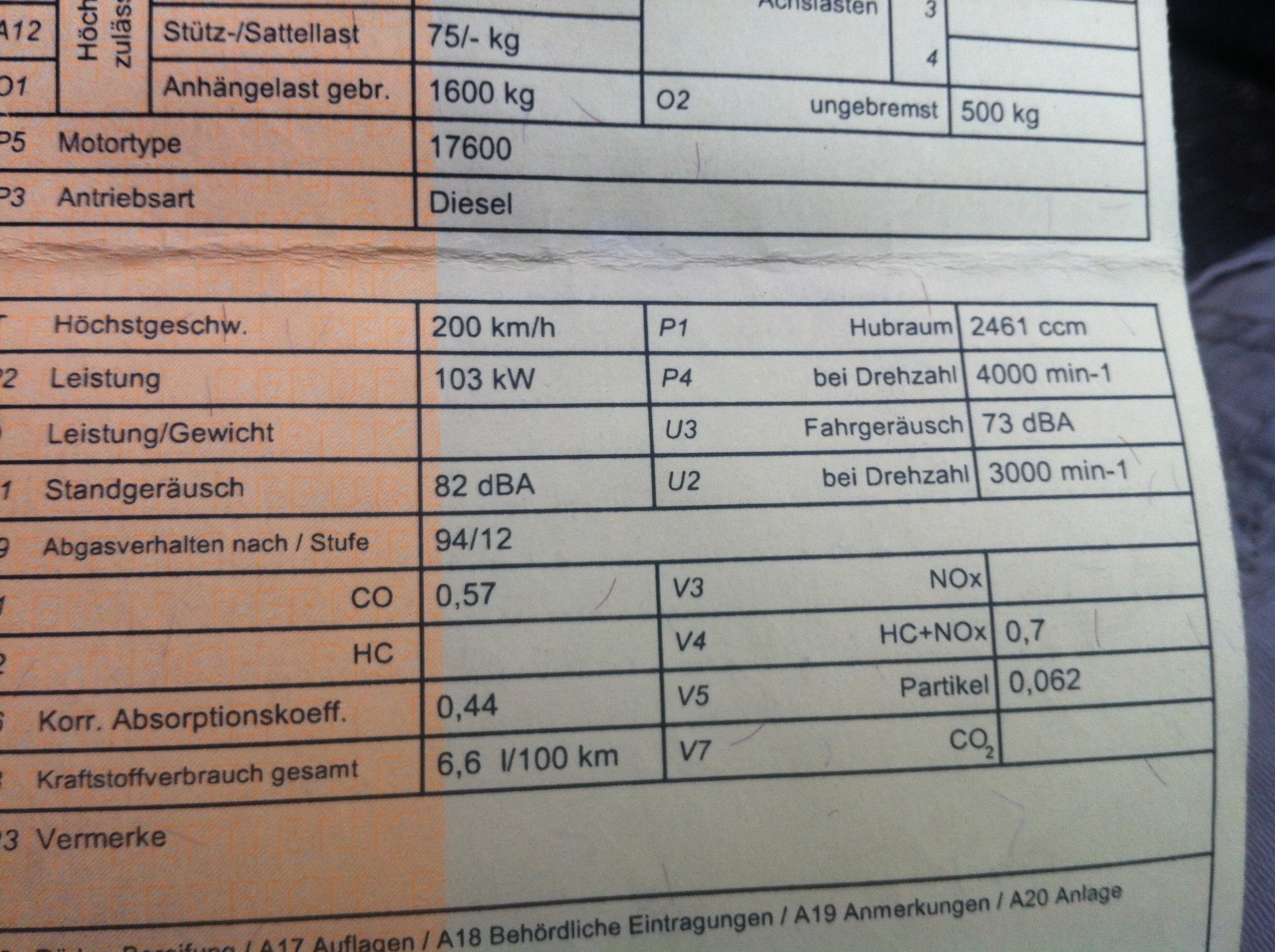

Post22-01-2013, 11:27    Subject: Quote
Hello.
Attached you will find the data from the car's registration documents. "Corrected Absorption Coefficient" is the value used as the turbidity factor. There are no units listed, and everything is a bit cryptic.
Here's the translation:
"Also, why should the value be so low – especially for the AEL? For example, in the t4wiki, there's a list that specifies 1.5 for that engine..."
What value are you looking for?

Post22-01-2013, 12:10    Subject: Quote
The absorption coefficient, denoted as k (kappa), is defined as follows:
k = (1/L) * l * n * (1 - N/100), where...
k = coefficient in 1/m.
L = Length of the absorption path in meters.
l = Engine displacement in liters.
n = Motor speed in revolutions per minute (rpm).
and N = linear scale value from 1 to 100.
Your vehicle registration documents will state the "allowable value." However, what matters to the TÜV (German technical inspection agency) is the "specified value." As long as you are within the legal limit, everything is fine...

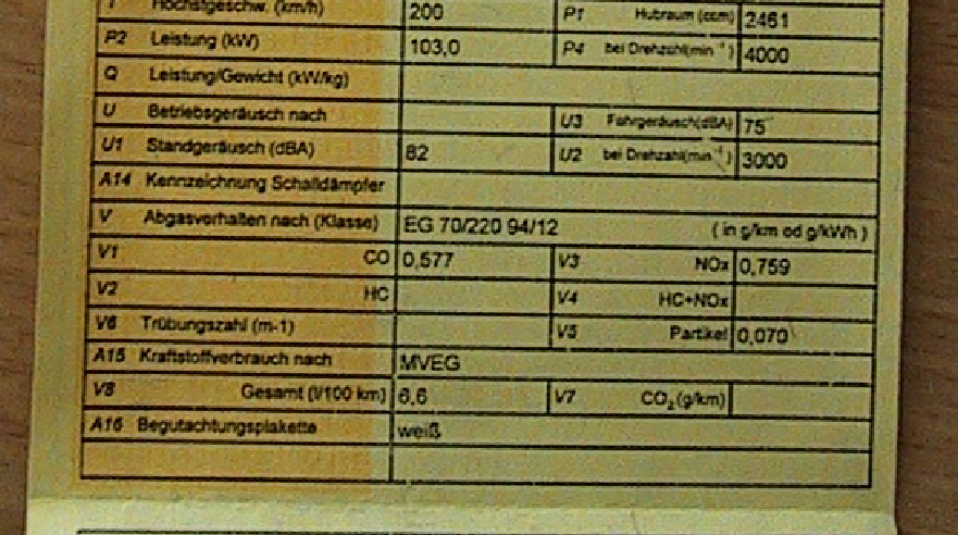

Post22-01-2013, 12:15    Subject: Quote
Hi.
Okay, I don't understand that, but did the inspector make a mistake? He entered the value 0.44 into his computer. With one vehicle, I achieved a result of 0.90 (which, in my opinion, isn't bad), and with the other vehicle, it was around 1.5 (normal).
However, I find the approval process for the second vehicle much more interesting. If you look at the same line, it states something DIFFERENT (see attachment).
Does that mean the inspector simply didn't look closely enough?
What would the turbidity value be if we calculated it using the formula (sorry, math isn't my strong suit)?
THANK YOU

Post22-01-2013, 14:21    Subject: Quote
The core of the "Pudels Kern" initiative involves changes to Austrian regulations that allow for national standards exceeding EU limits. Austria likely implemented this earlier (edit: in 2004?), and Germany did so on July 1, 2012. (You can search for "AU Richtlinie 2012" for more information).
In short:
- AU limit value = sticker value, indicated on the nameplate (in a rectangular box).
- if not available: manufacturer's specified value;
- if applicable (though not currently in use): 2.5 m⁻¹ for installations before October 1, 2006, otherwise 1.5 m⁻¹.
Earlier, I mentioned a limit of 2.0 for my 1Z engine, which might be the manufacturer's target value since there isn't an official sticker value available.
Are there any suggestions on where to find manufacturer's specifications? These might be of general interest.

Post22-01-2013, 14:28    Subject: Quote
"No, Herbert – that 0.44 isn't the turbidity value; we already clarified that above. There's NO indication on the car, so the 1.5 can be used. I always had a 1.5, and currently with my older vehicle, even a 0.8 (which is an EXCELLENT value considering the new measurement range)."

Post06-02-2013, 16:28    Subject: Quote
INFO from Volvo Austria:
Generally speaking, the specified value of 0.44 is a factory specification and is correct.
However, this is the approved measurement value and not the limit for an exhaust test, which we are aware of.
"If I provide my vehicle identification numbers (VINs), I will receive a written confirmation for my cars."

Post06-02-2013, 17:30    Subject: Quote
The fact that the value of 0.44 cannot be correct is evident because engines with a DPF usually have a specified consumption of 0.5 - 0.6.

Post07-02-2013, 20:45    Subject: Quote
So, the value of 0.44 refers to the "Bacherach" measurement method, which is no longer used.
