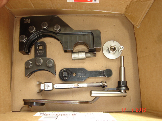

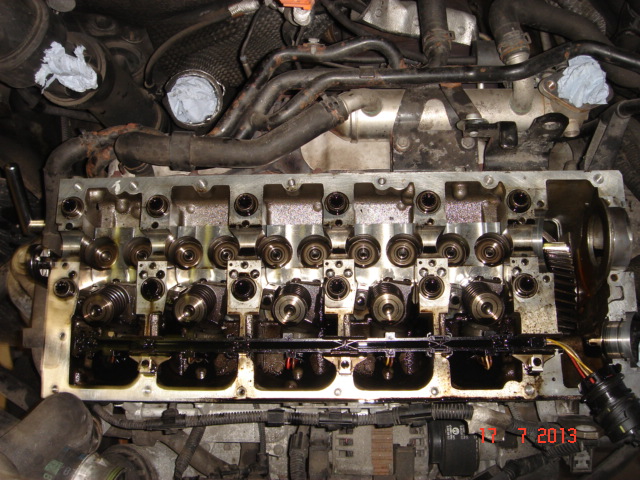

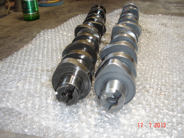

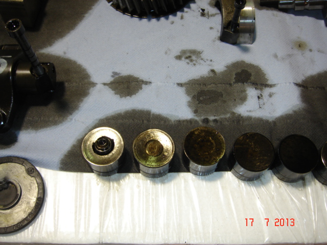

I haven't been active here for a while, as everyday life keeps getting in the way. Just a few days ago, I had a problem with a T5 BPC engine (year 2007) and wanted to share it with you. The vehicle sometimes had a rougher idle during cold starts for the first few seconds, but then everything was fine again. Lately, however, the vehicle's performance felt sluggish (noticeably less power at low speeds). One day on the highway, there was a loud knocking sound, as if there were no air filter anymore, and the engine ran very unevenly and had no power whatsoever (our old tractor at home sounded better).
So, the final result: The camshaft is completely worn out, and one hydraulic lifter has a hole (worn through). Please see the attached pictures. Without this special tool, it's impossible to correctly re-align the timing. Conclusion: The vehicle is running again, but are you familiar with this problem in the T5? I personally thought that the Audi V6 TDI camshafts were known for being prone to failure, but it seems the T5 also has a similar issue...
 Spezialwerkzeug fĂŒr BPC Motor

but do you know about this problem with the T5? I personally thought that the Audi V6 TDI camshafts were very prone to failure, but it seems the T5 also has a problem...
These problems are not only present in the T5. icon_wink.gif However, with the T5, this is considered to be normal.
Depending on the mileage, the first thing to check in the service booklet is whether everything has already been replaced. icon_lol.gif icon_wink.gif

Slowly but surely, as even BXX engines with faulty NW components fail, they will try to blame it on something else, I have no idea what!
These engines are not the only ones affected. All models from production year 2005/2006 onwards with either tappet valves or rocker arms (but *not* roller rockers) are more or less susceptible to this issue. It's simply a matter of understanding that the camshafts designed for two-valve engines in this configuration are, regarding material quality, just too narrow. And when even one of those parameters deviates from the norm...
The problem isn't the oil itself, but rather the design and materials used, including the artificially increased oil consumption. Any remaining safety margin is then sacrificed to cost-cutting measures.
Just two or three generations of engines ago, with mechanical valve lifters (tappets), a camshaft in a VAG engine would typically last for the entire lifespan of the engine, or they were virtually indestructible. These engines, however, experienced high loads regarding valve timing and RPM compared to today's standards. Some gasoline engines even had double valve springs. And all of this worked perfectly fine with the cheapest motor oil.
