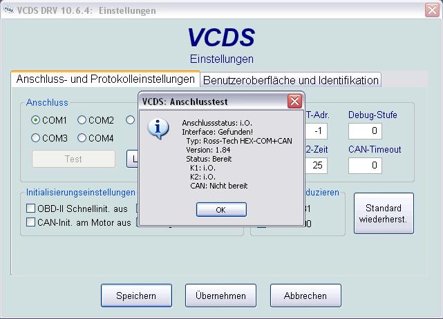

No green LED indicates no power or ground at the interface. icon_confused.gif It's actually quite simple to determine this.

Post27-09-2011, 20:14    Subject: Quote
Thank you, I found the errors icon_smile.gif.
I had the ground connected to PIN 5 (signal ground), but now I've connected it to PIN 4 (vehicle ground)...now the LED is also lit up green icon_smile.gif.
And now VCDS shows everything as being okay.
I'm going to go out again tomorrow after work and see if I can reach it icon_smile.gif.

matze-pe
Joined: 02/28/2011
Posts: 35
Karma: +1 / -1   Thank you, like it!
Location: Peine
2009 Volkswagen Passat
Registered VCDS User
Post27-09-2011, 20:47    Subject: Quote
I just looked up the pin configuration for my dashboard connector again:
http://gti-tdi.de/board2/index.php?page=Thread&threadID=2381&pageNo=1
It says "Mass on PIN5^^".
Should I perhaps connect both PINs to ground?
Vehicle and signal mass?

Post27-09-2011, 21:08    Subject: Quote
Okay, so yes, pins 4 and 5 are ground.
Thank you.

Post28-09-2011, 19:55    Subject: Quote
Unfortunately, that didn't work either. The WTT initialization process keeps running every time I try, using both COM ports.
"Unable to establish a connection; the green light is now illuminated on the VCDS connector."
