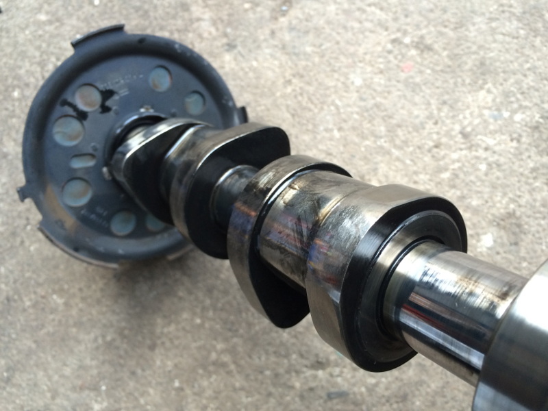

"Hey Guste, I suspect there might be some consequential damage to the camshaft and/or lifters due to oil starvation, which then progressed over time, and three months later it was in this condition."

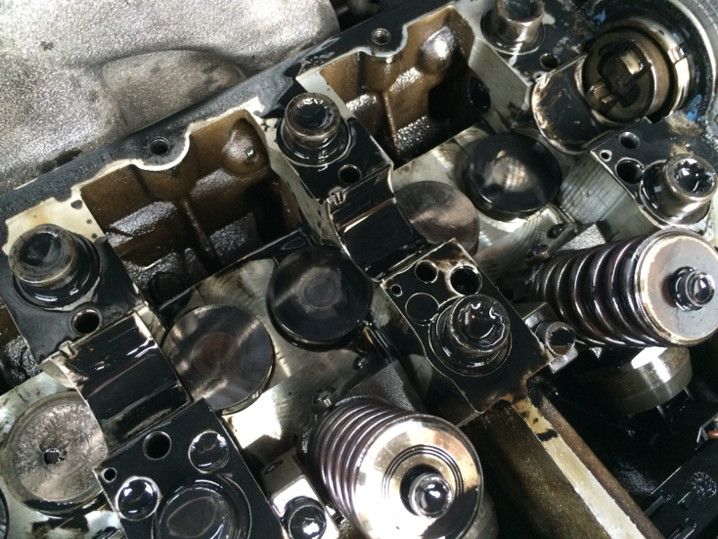

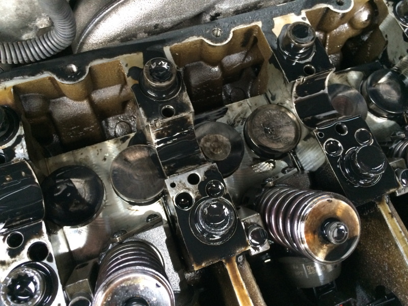

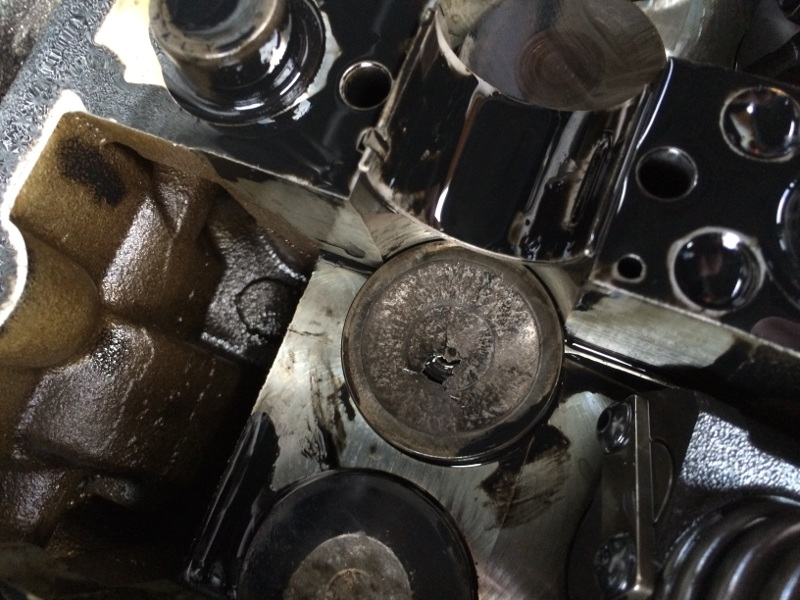

Post29-01-2015, 10:29    Subject: Quote
I hope this works with the links:
It's definitely interesting that all the intake valve lifters are "silver" and, except for the one in cylinder number 2, they are intact. The exhaust valve lifters, on the other hand, are all black (presumably hardened?) and have all started to show wear.
Schaut trotzdem alles recht gleichmäßig aus, bis eben auf Einlass 2. Zcylinder.
In my opinion, the problem existed even before the hexagon dilemma.
Translated on 15-07-2026, 18:55.

Hi Domi!
Please upload the original file icon_wink.gif here (there's a button at the bottom of the posting form to upload files), so that it remains accessible for future reference in months or years. }
The hydro next to it doesn't look very fresh either, if I saw correctly.
