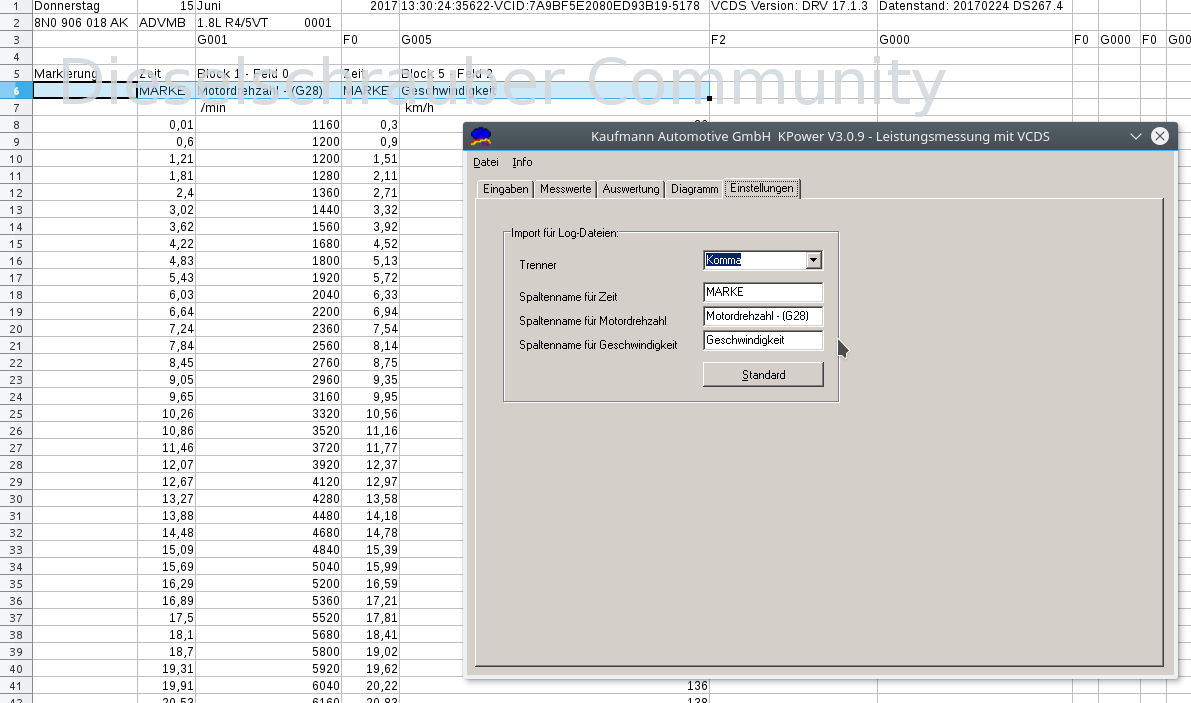

Tip: When selecting columns in VCDS logs, check what each line says to configure KPower correctly for each import.
It's simpler to use KOBD2Check right away.
Best regards, Rainer

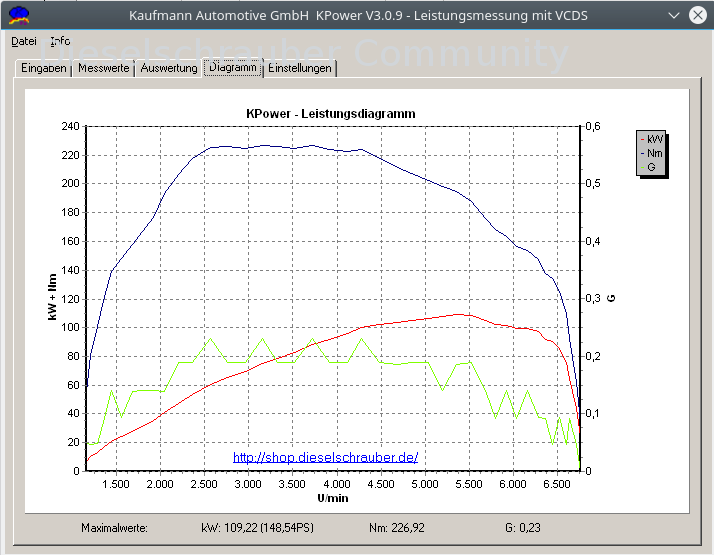

 KPower Leistungsdiagramm für einen Audi TT mit 150PS AUM Motor.

When importing VCDS and KOBD2Check log files into KPower, pay attention to the following regarding the file format:
1. Do not convert the .csv file, it's best to delete the useless csvconv.exe. Otherwise, the log file may be destroyed and become completely useless, not just for KPower but generally.
File header as it appears in the un-converted original (Example):
Tuesday, 07, May, 2019, 14:01:33:28906-VCID:7BA2068213626E7FCBF-802E,VCDS Version: DRV 18.9.1,Data Status: 20190215 DS296.0
04L 906 026 FN,ADVMB,R4 2.0l TDI H24 2011,
,,G004,F0,G008,F0,G000,F0,G000,F0,G000,F0,G000,F0,G000,F0,G000,F0,G000,F0,G000,F0,G000,F0,G000,F0,
Marker, Time, Loc. IDE00021, Time, Loc. IDE00075,,,,,,,,,,,,,,,,,,,,,
,MAKE,Engine Speed,MAKE,Vehicle Speed,,,,,,,,,,,,,,,,,,

2. Make sure that the program settings in KPower contain the correct column names. Note that any spaces included in the file should also be included! So, maybe
Code:
" /min"
3. VCDS does not consistently generate column labels across different versions and measurement block options. The best way to log the correct time unit is to use s for seconds.
Example of a correct log file header:
,s, /min,, km/h,,,,,,,,,,,,,,,,,,,,,
,0.19,1404,0.07,34,,,,,,,,,,,,,,,,,,,,,
,0.41,1444,0.32,35,,,,,,,,,,,,,,,,,,,,,
,0.62,1478,0.50,36,,,,,,,,,,,,,,,,,,,,,
...[/code]
The line ",0.19,1404,0.07,34,,,,,,,,,,,,,,,,,,,,," now means: 0.19 seconds after the log started, a speed of 1404 /min was measured, and 0.07 seconds after the log started, a speed of 34 km/h was measured.
