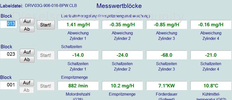

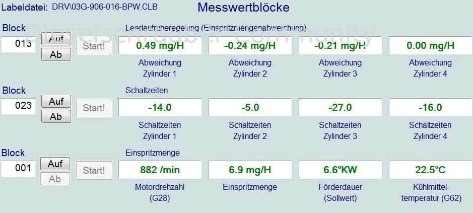

Right after starting the engine and during the initial acceleration, I experience a noticeable jolt, as if there's a bad connection somewhere in the wiring harness. Afterward, you can mainly feel that the car is vibrating.
Attached are images showing the values in both cold and hot states, along with a log file.

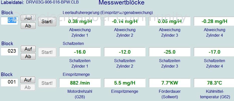

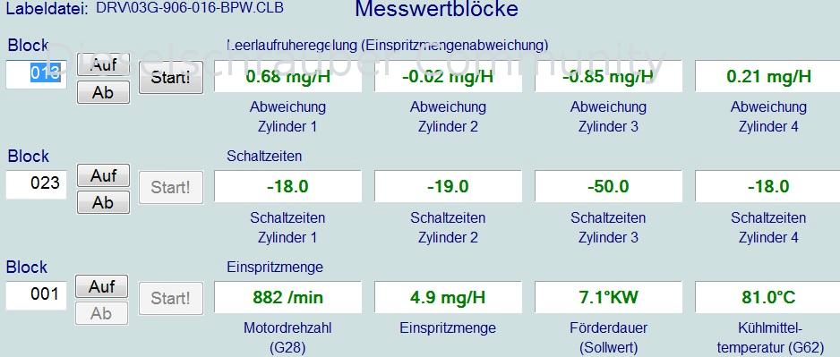

Post16-03-2020, 18:48    Subject: A4 BPW vibrates/jerks Quote
I've now installed a new old pressure differential element and new seals, and I've swapped the connectors of the pressure differential elements.
The strong jerking is gone, but it's still vibrating a bit, although that could also be coming from the dual-mass flywheel.
"3 Zylinder is still occasionally dropping to -65, but the cost of repair now exceeds its value."
