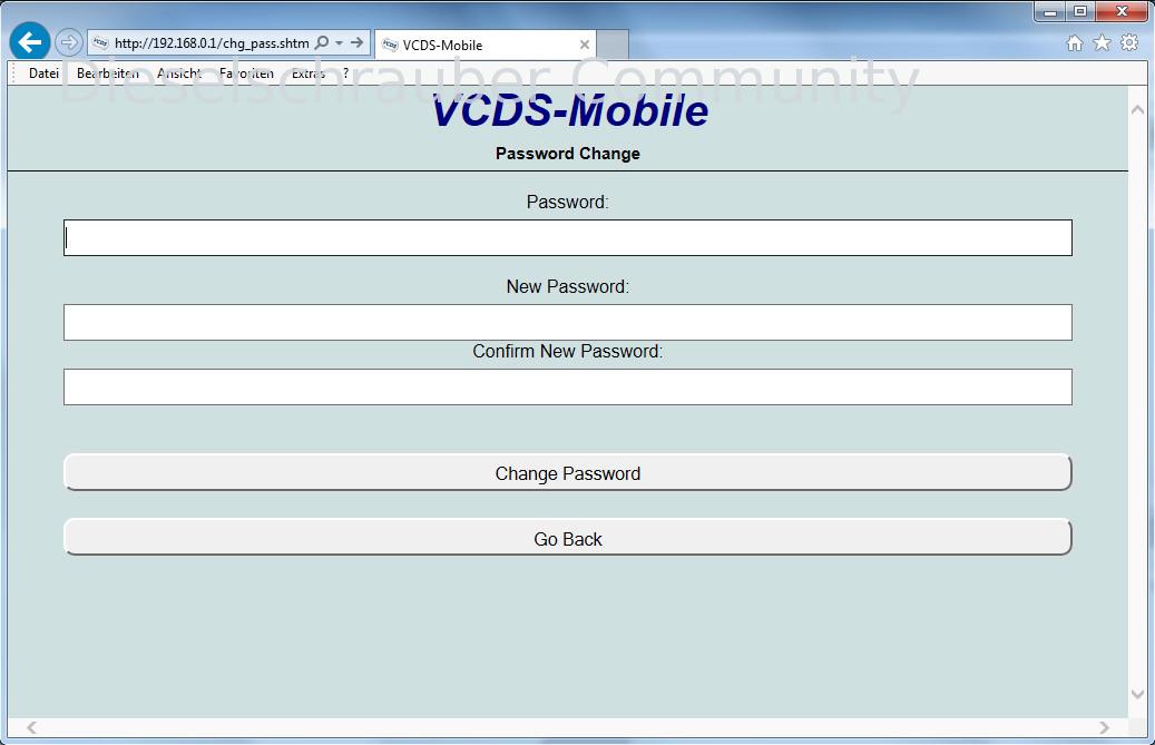

Hey!
Is it possible to change the default password for Hex Net, and if so, how?

Hi, open your web browser and enter the IP address of the HEX-NET device (default: 192.168.0.1), then log in to VCDS-Mobile, click on "Options," and then click on "Change Password."
 VCDS-Mobile® Test, HEX-NET® Interface, Passwort ändern.

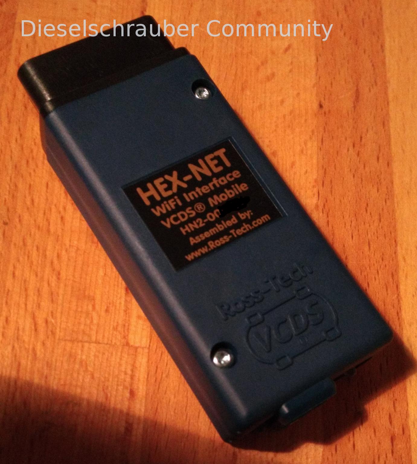

Post15-10-2020, 17:59    Subject: Is the VCDS Hex Net password changeable? Quote
Update: There is a revised hardware version of the HEX-NET, identifiable by its blue casing and a serial number that starts with "HN2-...".
New to the next-generation HEX-NET is the preparation for DoIP. If that ever becomes relevant, the hardware is ready for it. icon_smile_thumb_up.gif
 Neues HEX-NET Generation 2: blaues Ross-Tech HEX-NET
