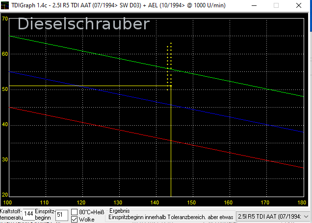

I checked the start of fuel injection using the default settings in VCDS with the engine at operating temperature.
The value usually fluctuates between the "early" and "optimal" lines at 90°, but every 2 seconds, a few values appear above that range, indicating they are too early.
After the test drive, the engine was slightly warmer, and the readings were generally a bit earlier, but they were still mostly within the range of the three lines (i.e., acceptable).

You can use VCDS to display a "cloud" of fluctuating measured values, and I can show you a Screenshot of that here.

"Cloud", see appendix.
The engine temperature was approximately 86°C after driving for about 10 kilometers.

Regarding the setting, I wouldn't change anything for now; it's a bit early on average, but the MSG (Motor Start Generator) will compensate for that under load.
Less desirable are the (too) significant fluctuations in the injection timing.
Since the default setting mode disables the injection start control (with ESP set to its maximum late position), the following options are possible:
- Mechanical wear of valve N108 for injection start.
- Mechanical wear in the high-pressure section of the electrostatic precipitator (ESP).
