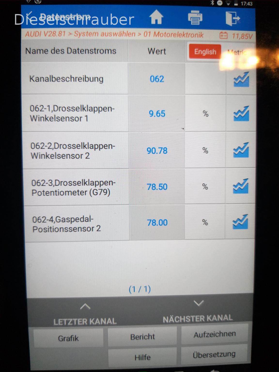

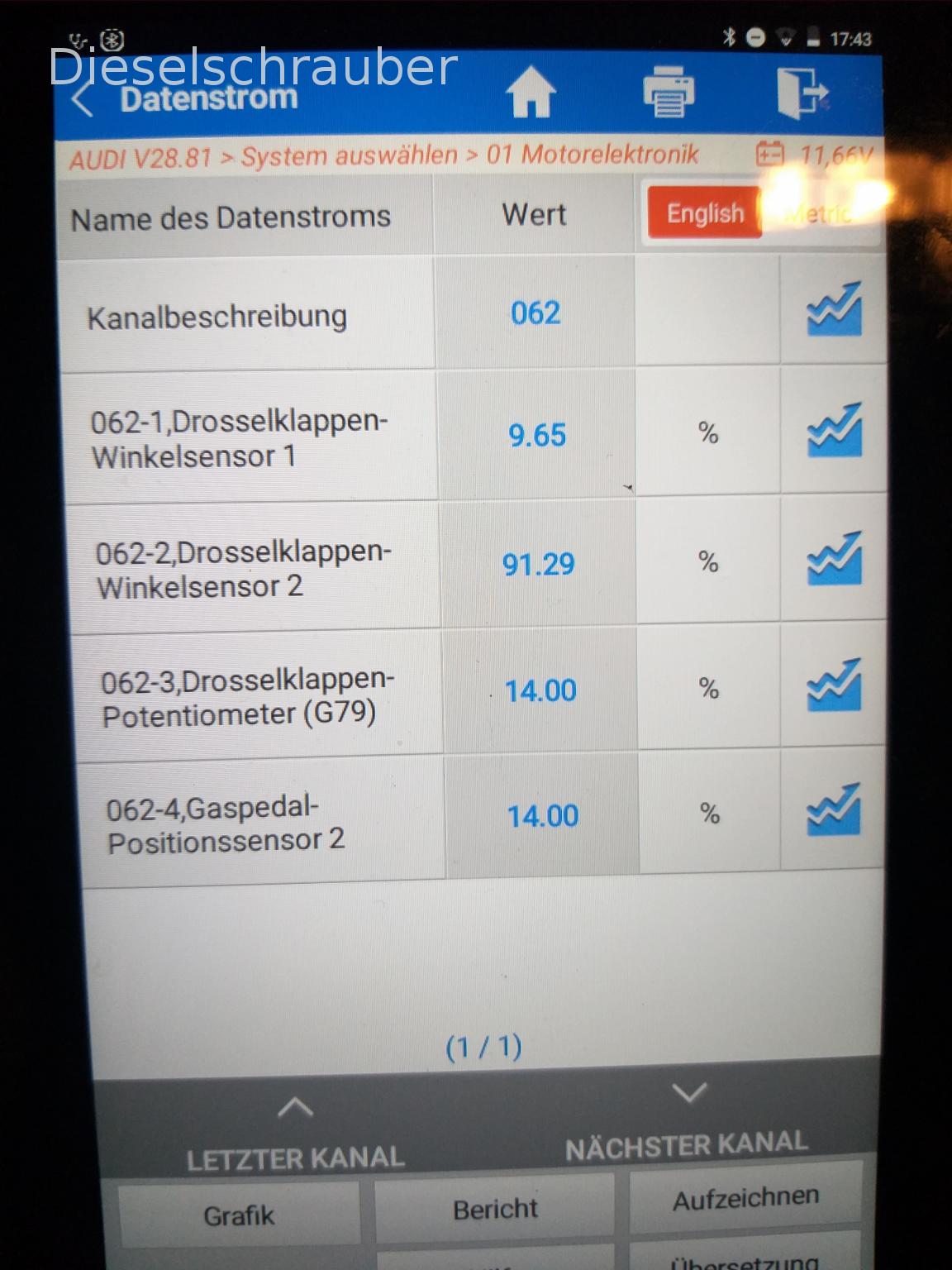

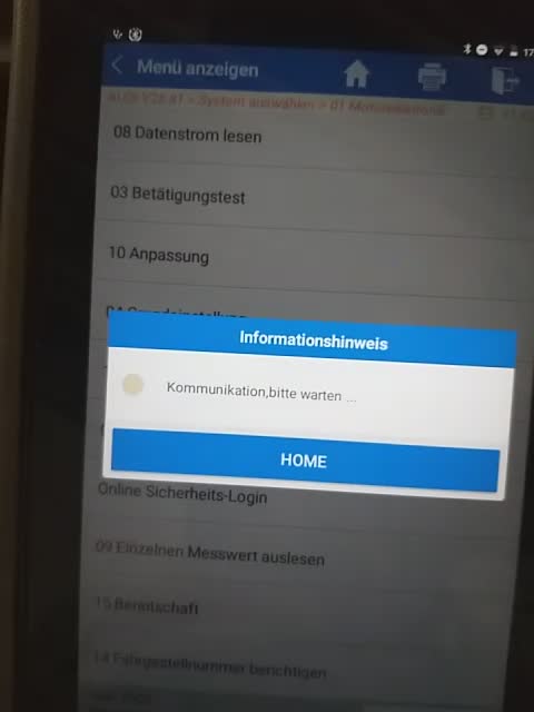

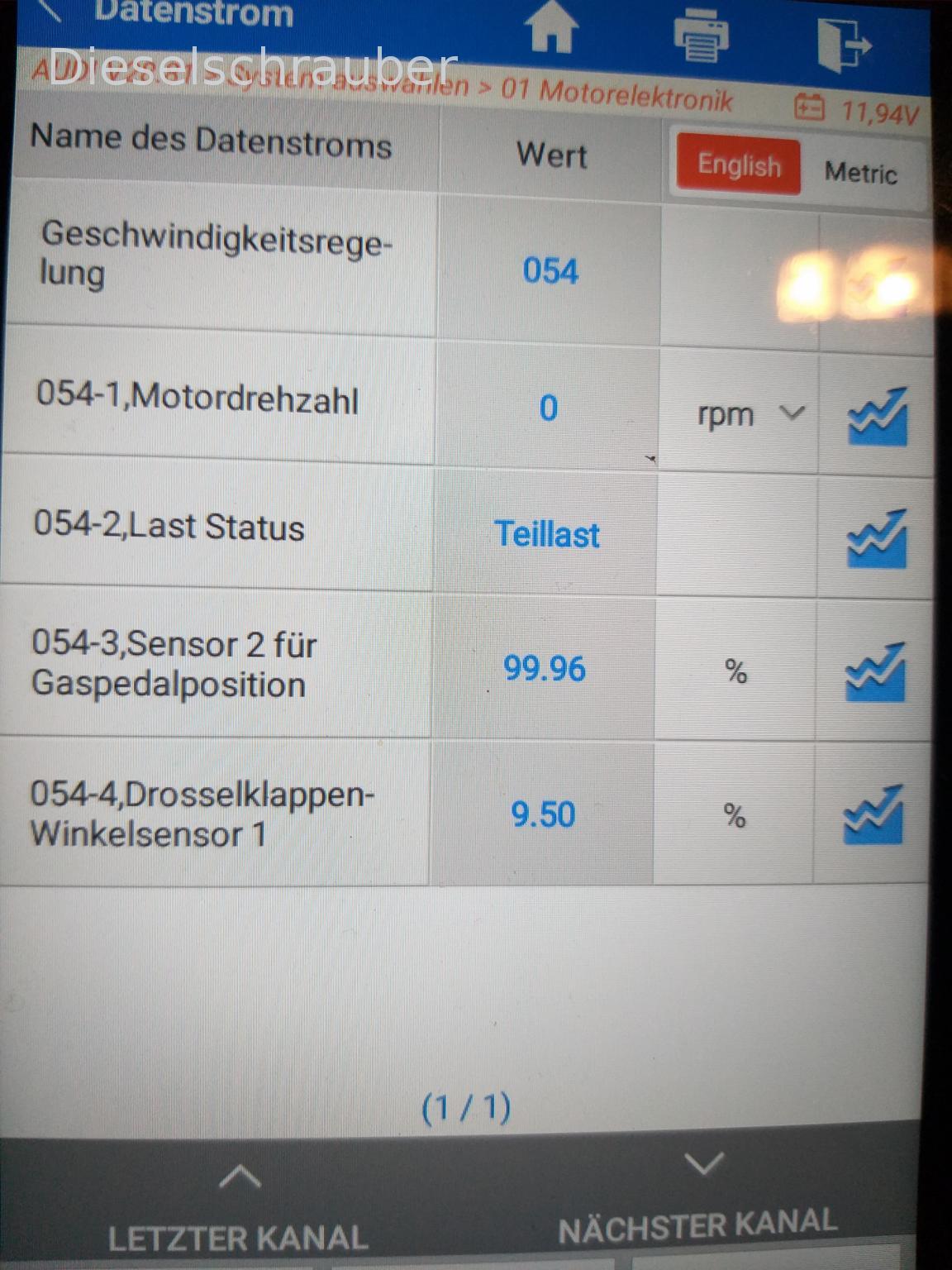

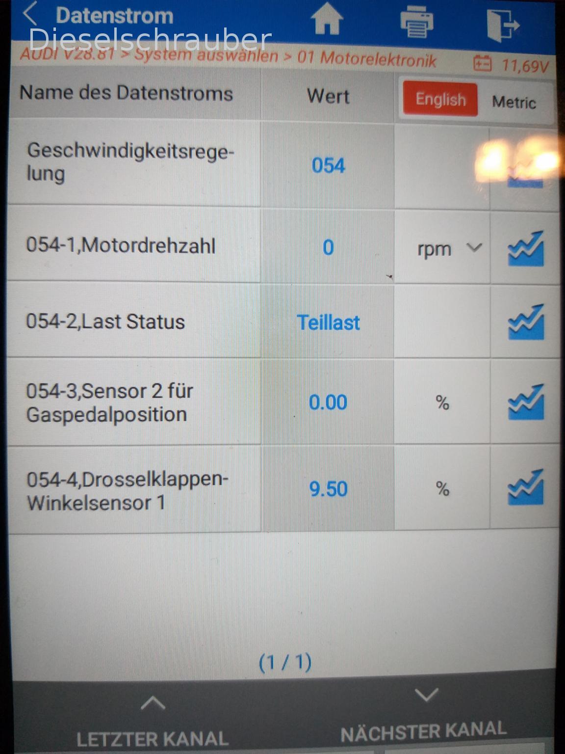

Hello everyone,
I have a problem with an Audi A2 engine, engine code BBY.
The throttle lever does not allow for the default setting.
When I perform a test with the actuator, the valve opens and closes properly. However, when I control it with the measurement block 60, it only vibrates slightly and opens minimally. Shortly thereafter, an error message appears.
I'm trying to upload a video, as well as some pictures of measurement block components.
Best regards, Daniel

Audi A2 Throttle Body, cannot set default settings - 20211018_172747.mp4
 So macht es, wenn man die Klappe grundeinstellen will
 File size:  4.65 MB
 Viewed:  2343 times
 Gaspedal ganz durchgetreten, sind da 78% ok ?
 File size:  5.79 MB
 Viewed:  2508 times
 Gaspedal in Ruhestellung, passt da der Wert 14% ?
 File size:  5.07 MB
 Viewed:  2667 times
 Gaspedal ganz durchgedrückt
 File size:  6.59 MB
 Viewed:  2497 times
 File size:  6.2 MB
 Viewed:  2510 times

Post19-10-2021, 19:16    Subject: Audi A2 Throttle Body, cannot set default settings Quote
Okay, so.
Yes, it works the same way as in the instructions.
It is also possible that this is due to the fact that the error code P1581 "Base setting not performed" is stored in the fault memory. This, however, cannot be deleted as long as it is not linked icon_smile.gif.
