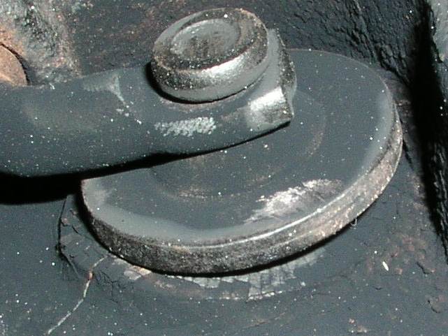

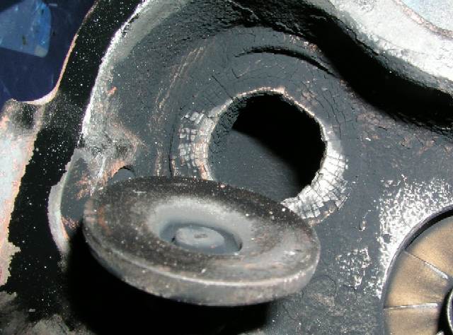

The casting around the wastegate hole is swollen like a sponge. This caused the wastegate valve to sit crookedly and no longer close completely. I've seen a GT15 WG turbocharger before with cracks around the hole, but in that case, the valve was still sealing properly.
Thank you very much for your help!

Swollen? Take some pictures, I'd like to see them.

Post03-12-2006, 15:09    Subject: Quote
Okay, I took some pictures.
Regards,
Thomas.
