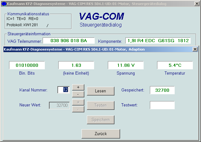

To change the preheating time, the following steps are necessary:
  • The engine coolant temperature must be low enough for the glow plugs to activate, e.g., 5°C. Otherwise, no changes will be observed.
  • Turn on the vehicle's ignition.
  • Connect to the engine control unit (01) using VCDS.
  • Perform a login with the code 12233.
  • Go to adaptation group 12 via control unit adaptation.
  • Change the default value (e.g., 3276) to 32700 and save the value.
  • 8)Disconnect from the engine control unit.
  • Turn off the ignition and wait a few seconds.
  • Go back into the engine control unit and perform the same steps as above. Of course, a new value doesn't always have to be saved. In field 2 of group 12, you can now see the preheating time, which was active after the last "ignition on".
  • Adaptionskanäle bei VCDSThis eliminates the fear of cold starting while idling below 0°C!
