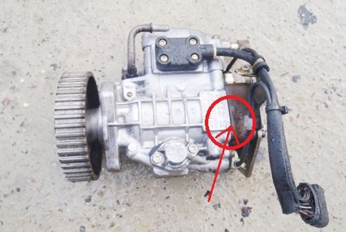

Ich fahre einen Ford Galaxy 1,9 TDI 90 PS Motor kz. AHU.
"Because the car has been starting increasingly poorly for weeks, I took a closer look yesterday and discovered that the fuel injection pump (Bosch) is leaking."
- EDIT by mod: Image attached.
I've marked the spot. Could this leak be the reason why the engine is hard to start?
I've also noticed that the fuel in the transparent hose is slowly flowing back towards the diesel filter.

Please check the following:
- Compression
- Injection timing.
- Check nozzles.
- KW wheel (searching for "1Z KW wheel" will help you find it).

Hey everyone, as I mentioned, I had the fuel injection pump sealed today. It cost me €117. I put everything back together, and lo and behold! It started right up, no air bubbles, no sputtering!
