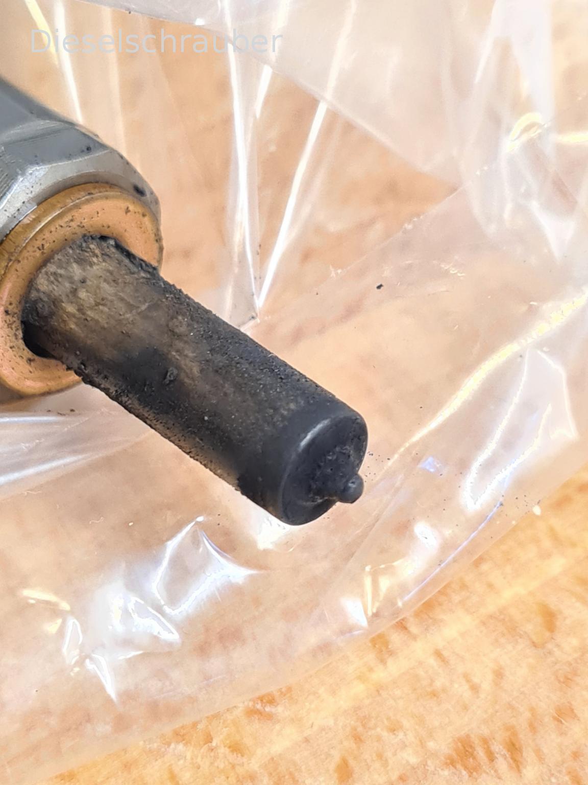

Post21-09-2022, 18:21    Subject: 2.0 TDI Injector Wear: Early Symptoms & Causes Quote
Hi there,
I'm back to working on the topic. And I'm in a situation that's not quite ideal.
I (somewhat hastily) bought four brand new (04L130277AC) Bosch injectors (at the price of refurbished ones), which are compatible with my engine code CRBC, but according to the list, they are suitable for Euro 6 vehicles. Mine is Euro 5, and the CRBC engine code was available in both Euro 5 and Euro 6 versions (the latter with a NOx storage catalyst and two EGR valves...).
"I had the 04L130277E part installed, which Bosch has since replaced with the 04L130277KE. I have a question for Bosch about whether the 04L130277AC part is backward compatible with Euro5 standards. Unfortunately, the technical employee who was looking into this matter is unavailable for the rest of the week. I likely won't receive an answer until next Monday, and I imagine the employee will probably err on the side of caution."
What do you think? Are they compatible?
The new calibration code is at least accepted by the engine control unit, which I have verified.
I removed injectors 3 and 4 today... they came out without any problems, with just a little bit of gentle prying.
The image from the third one is attached.

Post21-09-2022, 21:33    Subject: 2.0 TDI Injector Wear: Early Symptoms & Causes Quote
I had 04L130277E installed, which, according to Bosch, have been replaced by 04L130277KE.
I now have a question for Bosch about whether the 04L130277AC are backward compatible with Euro5 standards. icon_idea.gif
Bosch...List........ Injector poker }
Why don't you check with VW (AKTE) to see what parts are supposed to be included? Or just try it out - if it works, that's good; if it works for a long time, that's even better.
Translated on 08-09-2026, 23:49.
