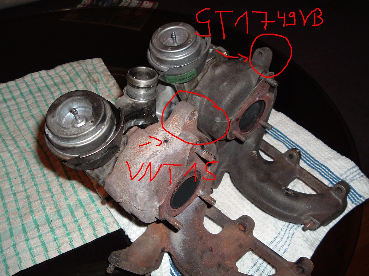

Hello everyone.
As I announced yesterday, today I replaced the turbocharger on my Golf IV ALH. The original turbo was a VNT15. I'm replacing it with an ARL turbo, specifically the GT1749VB model. Everything is the same between the two turbos, except that I need to rotate the housing slightly on the ARL turbo to make it fit.
"I also have two problems: The loaders are supported downwards by a bracket attached to the block. To achieve this, the loaders have an eyelet that is screwed into the bracket. This eyelet is rotated 90 degrees on the RL loader. Does anyone know if the bracket is different on the ARL model and whether I can use it?"
Ausserdem passt der alte Ladelustschlauch der zum LLK geht nicht auf den Lader. Weis jeamnd von euch welchen ich da nehmen kann ? Bilder hängen an. Best regards.
[url]http://www.... [Broken link][/url]

I'm sorry, I forgot. Here are the images again:
 Turbo Conversion Problems: Troubleshooting Guide

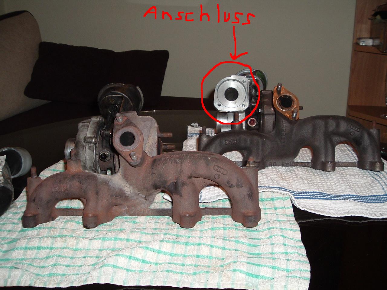

Here:

Marzocchi Posted on: 2005-10-05, 16:24
Title: Question about turbochargers.
"Die Sonne scheint hell und warm. Die Vögel zwitschern fröhlich in den Bäumen. Ein leichter Wind weht durch das Gras. Es ist ein perfekter Tag für einen Spaziergang."
I'm sorry to bother you again, but this is really important. I'm feeling quite lost right now. Has anyone of you ever seen a compressor outlet on a TDI turbocharger that looked similar to the one circled in the picture? If so, please let me know immediately. Thank you!

Post06-10-2005, 9:04    Subject: Turbo Conversion Problems: Troubleshooting Guide Quote
The problem is that I've already ordered various hoses from Volkswagen, and none of them fit the flange at the compressor outlet.
Normally, the hoses are connected and secured with a clamp. This flange with the three threads is something I've never seen before. I suspected that someone might have tampered with it, but the data for the turbocharger is on the compressor housing, so it can't be. It's very suspicious!
Golf IV - ALH - Erstzulassung 9/99

You should ask VW for the parts for your turbocharger. It's an older model, and it might have a different connection. The parts service usually only provides the newer versions if parts have been replaced, and while the 038253016D was replaced, to my knowledge, only changes were made to the bearing (the successor, 038253016G, is now also available in revision 5). It looks strange on yours; I also have the 038253016D, but mine looks different. Are you sure it's the "D" model? Sometimes the markings are no longer legible. Visually, it looks more like the "F" model. Could you take a picture of the type plate?

"@ Hati It's relatively rare to get a test drive with high-performance models at the age of 22. Sure, if you really push for it, maybe you can, but not easily. I'm also not sure if they even have those models available for test drives anymore, especially since some of them are no longer in production. And you don't just casually look at the loader either. Besides that, a different loader with a different compressor housing (XX016G) was used starting in 2002."
No one messed around with the loader; they completely dismantled it.
"I now know that the charger normally has a kind of "silencer" attached to it, which is included with the charger and is missing here. It's not sold separately. I have two options: either I can have a custom-made flange machined that I can use as an adapter in between, or I can install the compressor housing from a GT1749VB turbocharger, part number xxx016G. That should fit and have the standard connection."
I found someone who has a single enclosure - I hope it fits.
I've been to the Volkswagen dealership countless times about this issue, and they simply have no idea what's going on – it's shocking!
"PS: It's definitely a 'D' type nameplate and it's still readable."
