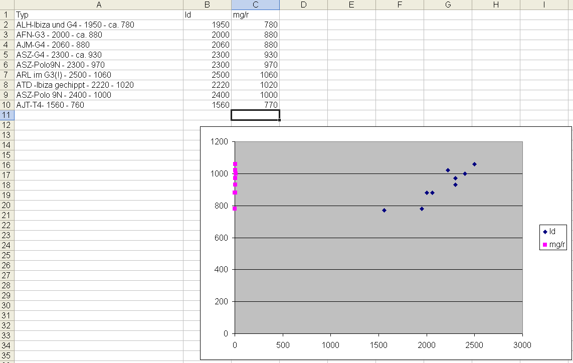

leo_b
Avatar-leo_b
Joined: 02/03/2005
Posts: 145
Location: Hamburg
CAN Support
Post15-05-2006, 18:29    Subject: loading pressure to air mass Quote
hi,
I had some fun and the values from the thread: /viewtopic.php?p=84423#84423
graphically prepared.
From this, one can tend to recognize a certain dependence.
my conclusion:
low load pressure = low air mass
high load capacity = high air mass
Therefore, my air mass should also match the loading pressure?!
Best regards, Leo

Post15-05-2006, 21:57    Subject: Re: Loading pressure to air mass Quote
leo_b wrote:
my conclusion:
As a general direction: yes.
However, of course, the displacement per cylinder (!) is the main factor besides the LD.
Furthermore, the valve timing and the exhaust backpressure (high backpressure -> lower gas exchange = lower air mass).
Everything, of course, is for air passages without holes and an intact LMM... if it's defective, it's just measuring garbage.
