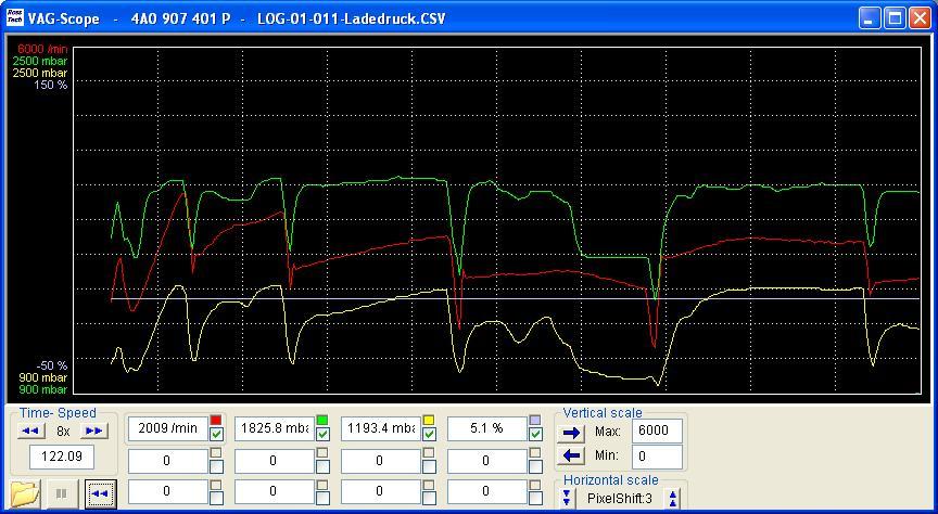

First of all, thank you for the help regarding the ESP setting. It worked perfectly, and the TDI graph makes it really easy. Unfortunately, nothing has changed regarding the lack of power... and I've searched the forum, but I'm now a bit more knowledgeable, although my knowledge isn't enough to pinpoint the problem.
I logged data from measurement block 11 because I suspect a turbo problem. As expected, the actual value doesn't reach the target value (yes, I'm still looking for the cause), and it's consistently about 500 mbar too low. But what does the duty cycle mean? It's constantly at 5.1 (the gray line). Is something else completely wrong?
I have an A6 2.5 TDI (C4) with an AEL engine, which has a wastegate turbocharger, so a jammed linkage is unlikely. I've visually inspected the often-mentioned solenoid valve, and all the cable connections look good. The pressure lines also don't appear to be damaged. The only modification to the engine is a deactivated EGR (VA plate).

As expected, the actual value does not reach the target value (yes, I'm still looking for the cause), and is practically constantly about 500 mbar too low. But what does the duty cycle mean? It's constantly at 5.1 (the gray line). Is something else completely wrong?
"No warranty, starting from room 1Z."
The regulation only becomes active when the LD reaches its target and "wants to increase even further."
As long as the boost pressure is as low as it is in your case, the control system will initially remain inactive, waiting for the boost pressure to increase (which means the wastegate is closed) until it needs to become active.
It is normal for the TV to be constantly operating at its maximum power.

'You're right, the regulation only becomes active when the LD reaches the target value and 'wants to increase even further' (I found a Screenshot in a thread by dakoal, who also has an AEL, showing block 011).'

Duty cycle 5.1: Solenoid valve open, no boost pressure to the control unit, full boost pressure goes to the intake manifold.
Duty cycle: 94.9%. Solenoid valve closed. Boost pressure reaches the control unit. Boost pressure for the intake manifold is limited.
With a boost pressure of only 0.6 bar, while approximately 1 bar is 'desired' (target value), the duty cycle, according to VAGCOM, is 5.1, and the voltage at the solenoid valve, measured with an analog multimeter, is in the range of 11-13 volts.
