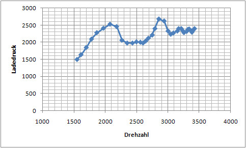

Post07-03-2008, 17:34    Subject: ASZ Engine Performance Issues: Troubleshooting & Logs Quote
The boost pressure curve is strange. Also, it has overboost up to 1.7 bar.
