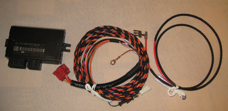

I retrofitted a tow hitch to my Passat 3C and installed an aftermarket wiring kit. Sure, here is the translation of the text from German to English:
"This should be from Bosal."
Now I have several errors stored in the error memory.
Okay, bitte gib mir den deutschen Text, den du ĂŒbersetzt haben möchtest.
***EDIT: I'm going to cut this short here: I initially thought there might be a software update from VW for this, but that doesn't apply to my vehicle. Thank you to vagtuning.
"Does anyone know of similar issues with other vehicles, or perhaps even a solution to this problem?" I'm concerned that constant communication problems might prevent the CAN bus from settling down, which could lead to the battery being drained.
"Error code log attached (VIN removed to avoid directly criticizing the dealer). Communication problems occur every time a key is removed from the ignition. The trailer hitch lighting functions perfectly, both with and without the ignition on." AHK-related errors occur in the body control module (BCM), comfort control module (CCM), gateway control module (GCM), and AHK control module.

vagtuning
Guest
Post15-08-2009, 21:51    Subject: 3C: AHK Retrofit, Bus Idle Issues Quote
I still have some Index D plus internal wiring harnesses available.
Only the wiring harness to the connector is missing.
 AHK
 File size:  710.48 KB
 Viewed:  12860 times
Joined: 07/27/2004
Posts: 2399
Karma: +435 / -0   Thank you, like it!
Post15-08-2009, 21:58    Subject: 3C: AHK Retrofit, Bus Idle Issues Quote
Do you happen to know if the errors listed above occurred with that?
What would you like in return?
vagtuning
Guest
Post15-08-2009, 22:03    Subject: 3C: AHK Retrofit, Bus Idle Issues Quote
I don't have precise answers to either the first or the second question.
Opinions or beliefs, but the latter doesn't really belong here either.
It was mainly intended to be informative; if you need anything, just reach out via private message.
