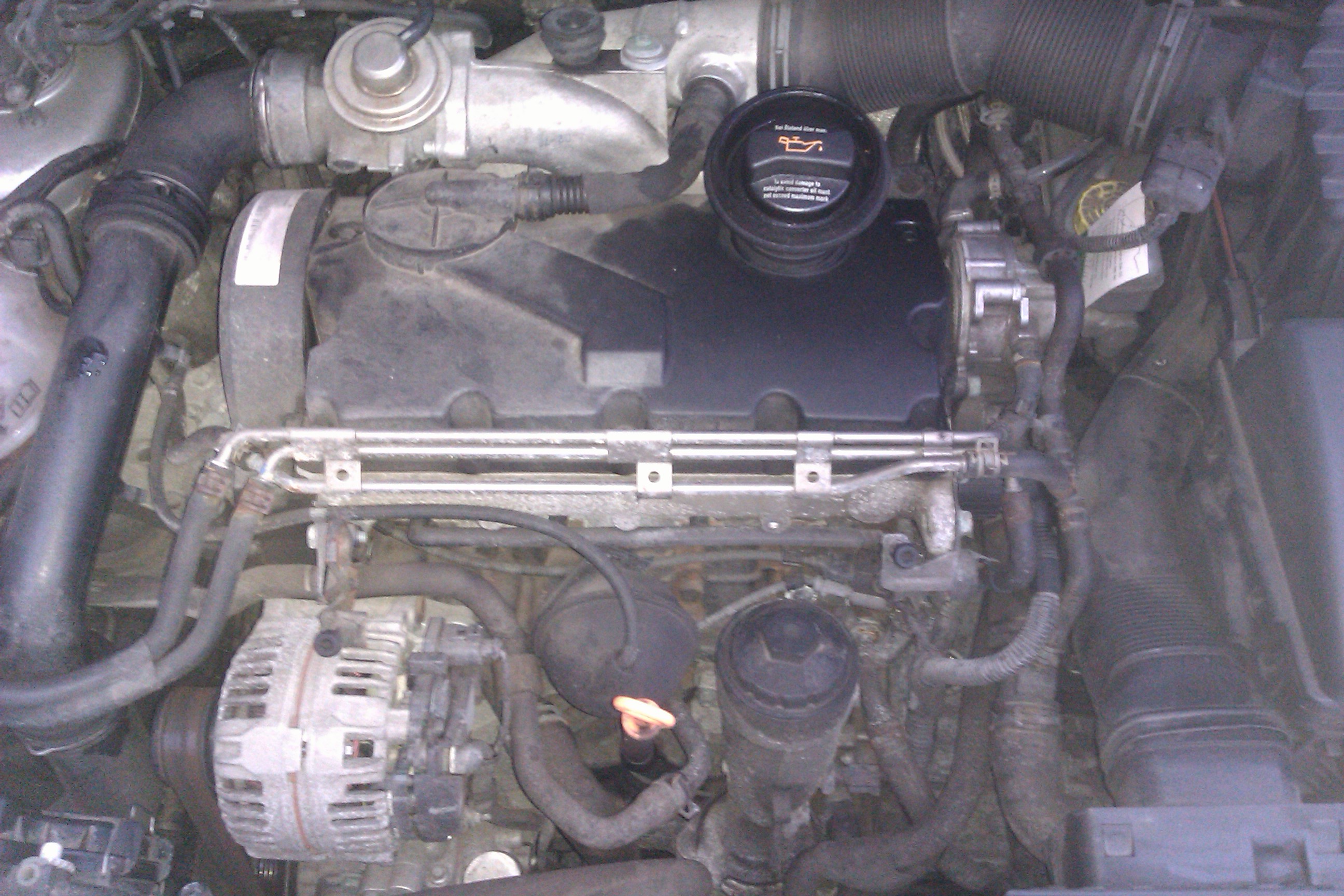

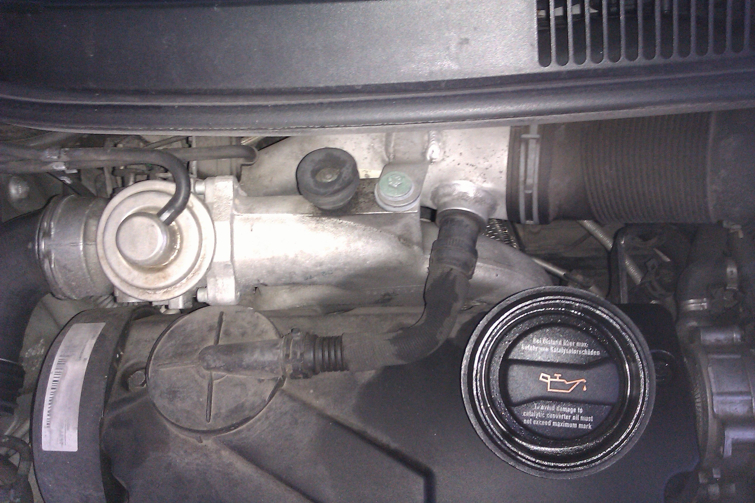

Hello everyone!
I'm having a problem where my coolant temperature sensor occasionally shorts out, which causes an error to be logged in the MSG (presumably a vehicle's diagnostic system). Furthermore, I've also noticed a slightly increased fuel consumption since the error started.
I wanted to replace this part now (I have a replacement ready), but I can't find it anywhere. Unfortunately, the Ibiza also has a very cramped engine compartment.
I would really appreciate it if someone could locate the G62 in the attached images, so I know exactly where to look.
Thank you in advance!

It is located on the rear right side of the cylinder head and has a 4-pin connector.

and it's really not possible to swap the gift. Look at it with a mirror, angled slightly below the tandem pump. It's installed facing in the direction of travel. Be careful with the retaining clip. If it falls off, you'll need to remove the lower engine cover.
, as viewed from the front icon_wink.gif.
No, only 2-pin! The AI receives the water temperature data from the MSG via CAN.
