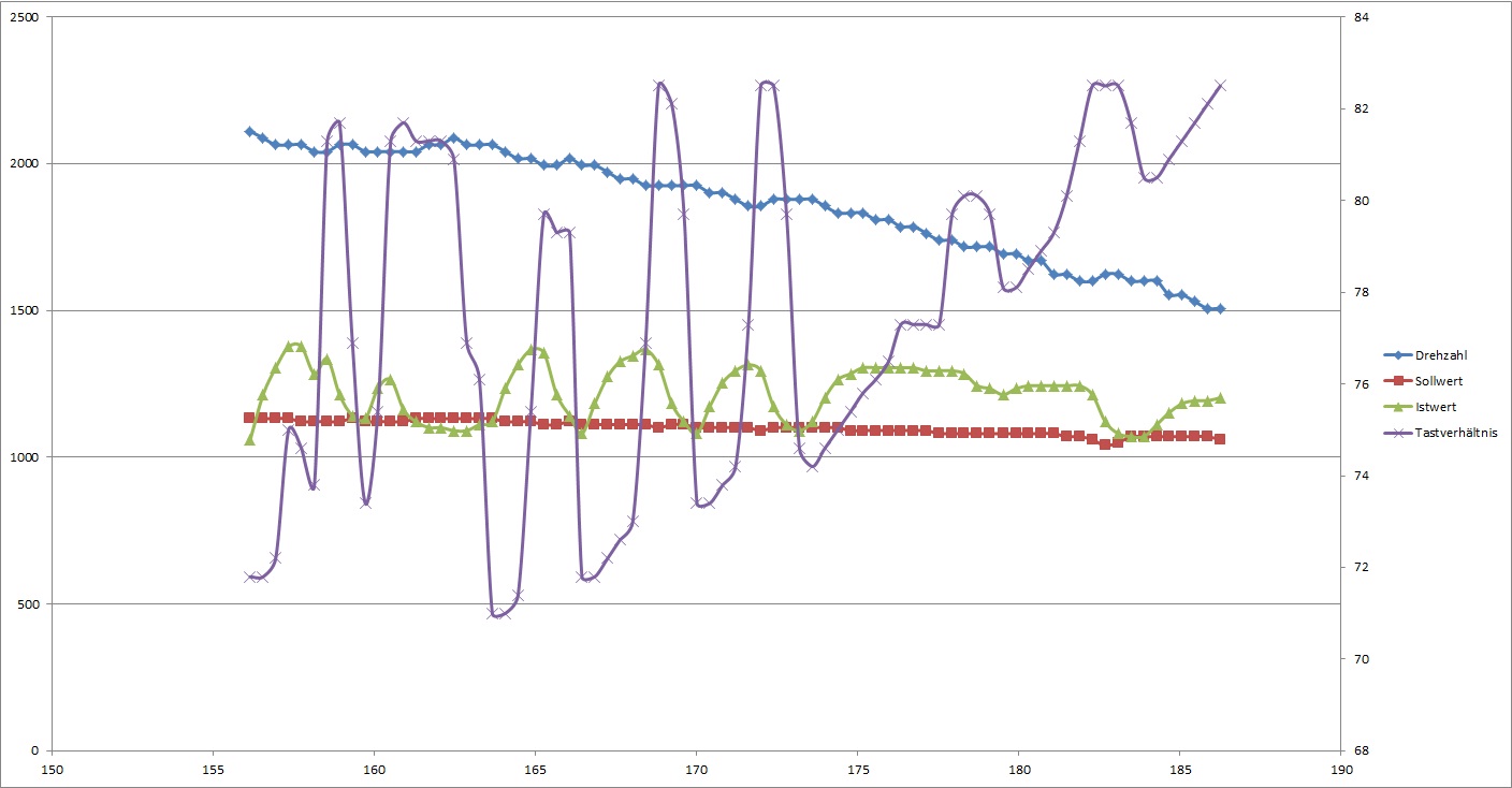

habe mal den Ladedruckaufbau gelogged (3. Gang Vollgas), weil meine VTG etwas schwergängig zu sein scheint. Der Ladedruck erreicht zwischenzeitlich fast 2.6 Bar. Is that still okay?
The engine is a 2.5 TDI BDG with 140,000 km (approximately 87,000 miles).
Thank you very much in advance.

What should I log with?

The car reminds me a lot of my experience 'back then'.  Some 2.5V6 engines have this issue.  Even without the front/main catalytic converter, it didn't show any improvement.  Manufacturing tolerances.  }

Is the dataset up-to-date? Theoretically, you can check if the VTG (variable turbine geometry) is functioning by disconnecting the vacuum pump, but I don't know if it's easy to access that part on this engine.

I tried testing the VTG with a syringe. I couldn't detect any stiffness. The rod followed the movement of the syringe plunger directly. However, I'm not sure if I pushed the 60mL syringe all the way in; it probably didn't reach the very end. The vacuum seems to be okay (-700 mBar). Could it also be the N75 valve? Unfortunately, the actuator diagnosis switches abruptly between 100% and 0%, making it difficult to test properly.
I've found another peculiar entry in the log. It seems like the boost pressure regulation is oscillating correctly here. This might have been during a thrust phase. Therefore, I'm not sure if it means anything significant.

Okay, it's possible that the control unit has a fundamental hardware problem that cannot be fixed by changing the software.
I can't really think of any specific reason related to the boost pressure control for that.
Just try replacing the N75 valve; it's not expensive and rarely causes any issues.
